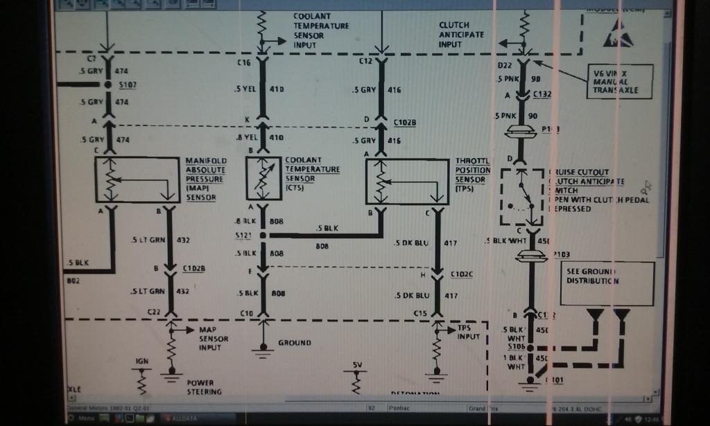

crazyd Posted July 17, 2018 Report Posted July 17, 2018 I've been wanting to broach this subject for a while now, so I hope this isn't too much of a hijack. My '92 has a '95 LQ1 that I retrofitted using the original '92 ECU, I assume with the BCFA calibration, and the programming has always seemed a little bit off. It's herky-jerky (surging?) below 1500rpm in high gear, along with some quirky drivability - like the revs fall off too fast, making smooth gear changes difficult. I talked to Ryan at Sinister Performance and he said it should be fine with that calibration, but it's definitely not. It's actually really smooth before it learns, then gets worse once it does. Wonder if going to the '93 BBUK calibration would improve it? Chris, why do you recommend the BCFA? Quote
White93z34 Posted July 17, 2018 Report Posted July 17, 2018 For his situation I believe I recommended the 91' BCFA calibration for the sake that it does not look for the clutch position switch that the 92/93 cars have. I think in talking to him in earlier threads he wasn't going to be able to add that switch or something to that effect with his swap. 92' Brought in the clutch position switch... not sure of its exact name. but its just an additional switch at the top of the clutch pedal that tells the ECM if the clutch in or not. It keeps the revs from falling face down when you go to shift, it helps driveability. Quote
Imp558 Posted July 17, 2018 Report Posted July 17, 2018 "Clutch Anticipate"? If memory serves me.. Quote
crazyd Posted July 17, 2018 Report Posted July 17, 2018 That must be the same switch used for the starter. That's exactly what I need, I wonder if somebody swapped in a '91 MEMCAL. I'll have to check it now. Quote
White93z34 Posted July 17, 2018 Report Posted July 17, 2018 That must be the same switch used for the starter. That's exactly what I need, I wonder if somebody swapped in a '91 MEMCAL. I'll have to check it now. Different switch, actually. Quote
crazyd Posted July 17, 2018 Report Posted July 17, 2018 Where is it then? There's a large black one mounted on the firewall that I thought was to for the starter, is that actually the "anticipator"? Now I'm wondering if mine's not working properly. Quote
White93z34 Posted July 18, 2018 Report Posted July 18, 2018 The one on the floor is just the starter safety switch. there is another one at the top of the pedal. it cancels cruise control and tells the ECM if the clutch is in or out. Quote
