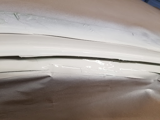

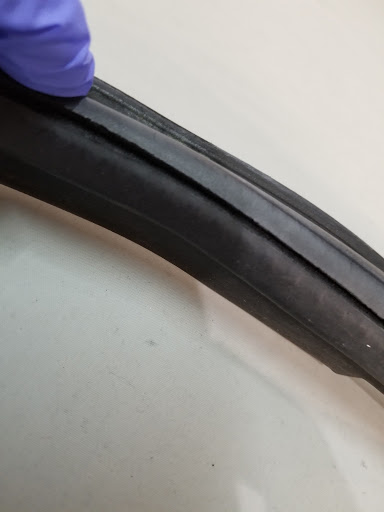

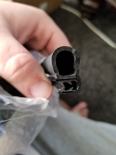

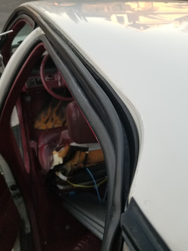

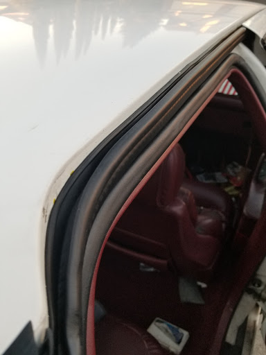

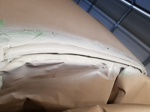

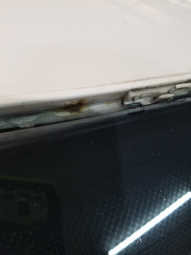

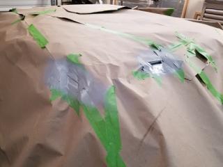

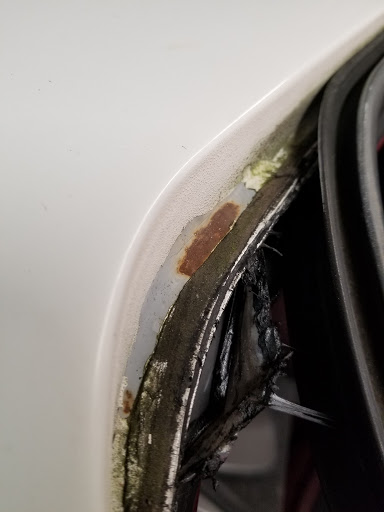

2001goldGTP Posted February 20, 2018 Author Report Posted February 20, 2018 Sorry, I had knee surgery on the 31st from the accident I had in Nov. I bought the steele rubber universal seal. It is no the same profile as the rubber above the doors. So i spent 8 days removing, sanding the rust, repainting and re gluing the seals. I used chemical guys rubber and trim goop with a heat gun to help soften the original rubber. I used the 3M rubber sealant to stick the rubber back on and some blue shop towels to help it form in the corners. Knock on wood it works lol Quote
2001goldGTP Posted February 20, 2018 Author Report Posted February 20, 2018 Attached are some pictures primergray 1 Quote
jiggity76 Posted February 20, 2018 Report Posted February 20, 2018 I'm interested to see how it turns out! I feel bad, if I'd known you were going to need parts, I would have held onto my 91 International sedan parts car I had. It was totally rotted out from Wisconsin road salt but had a really nice interior and things like weather stripping etc. By the way, what's going on with the back of the driver's seat? Quote

2001goldGTP Posted February 21, 2018 Author Report Posted February 21, 2018 Those first two pictures are the original seals back in place, my after photos loaded first, odd. My seat has fallen apart, its all sorts of FUBAR. I took the back off in an attempt to fix it, i just need a new set of seats lol Quote
