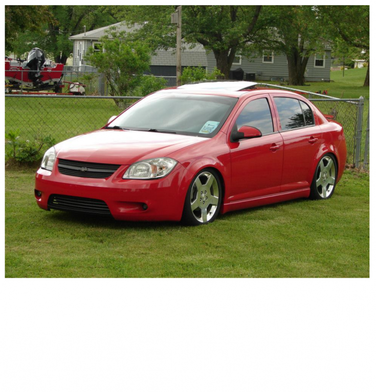

bluegtp91 Posted February 3, 2018 Report Posted February 3, 2018 New shocks; get some springs. Be done with it. If you buy cheap Ebay coils you're going to get what you pay for. I had $1500~ BC Extreme's with custom shocks on my Cobalt. It still rode iffy and was smashed to the pavement. Unless you have great roads and/or don't care about your spinal condition, then EBay coils are for you. For reference, it rides about as good as to bolting a milk crate onto a metal roller skate on pea gravel. digitaloutsider, Nas Escobar, jaredbonner1 and 1 other 4 Quote
