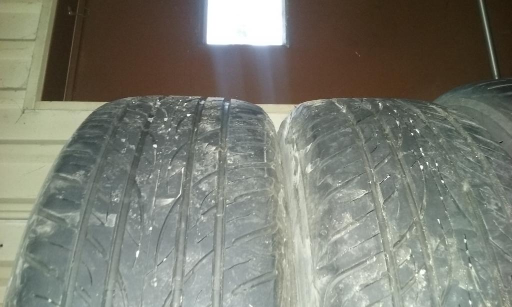

Imp558 Posted January 23, 2018 Report Posted January 23, 2018 50lbs must ride like a rock. Yeah I wasn't willing to find out, or how violent a blowout would be, 45 was scary at first but no problems yet. I'll be replacing my Envigors with Envigors. last year I nicked a curb with the sun in my eyes and took a little chunk out of the sidewall on both right tires, the left tires are worn slightly different so I'll end up replacing all 4 for the GS venture and then using the 2 used ones as spares for both cars. I don't even know what I'm running for wheels on the GS, my X-laces won't clear the second gen stuff supposedly so I'll probably grab a set of steelies and save for something aftermarket. Quote

Imp558 Posted February 2, 2018 Report Posted February 2, 2018 This year I put the snows on the SSEi, last year was so mild I didn't bother. These are run at 45 lbs.and to my untrained eye appear to be wearing evenly. Quote
