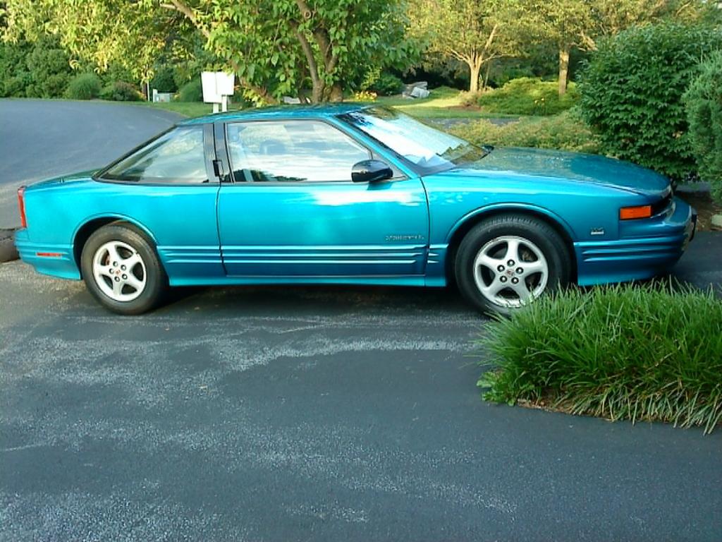

bluecalais79 Posted November 10, 2017 Report Posted November 10, 2017 Ok, first below freezing morning after it rained over night, the drivers side door froze and I was not able to get in from the outside. I had to go in through the passengers side and push open the drivers side door. Of note, the passengers side stuck a bit as well and I'm sure there will come a time (soon) when both doors will be stuck/frozen from the outside. Does anyone know of perhaps a spray or a good lubricant that may combat this? I remember my 1991 Calais having this issue, it got so bad that sometimes I had to crawl through the pass through from the trunk to get into the car. I can do this again with this car if needed but it's not what I prefer to be doing on a cold day. Any suggestions would be appreciated, thanks. The photo is from the 1994 I had but the door pull is the same style. Quote

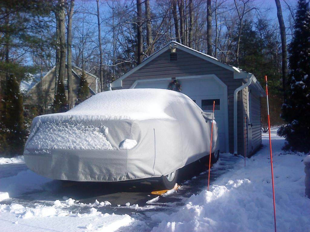

bluecalais79 Posted December 27, 2017 Author Report Posted December 27, 2017 And the photo shows why. I'm going to need dynamite to get that car cover off, it's frozen on there quite well. Quote

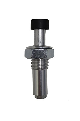

Imp558 Posted December 30, 2017 Report Posted December 30, 2017 Here's a mad ass thought, why are we waiting for our insanely rare door handles to break at all? These popper springs are an easy install and the door would pop open as soon as the handle releases so there wouldn't be any pulling on it. https://www.amazon.com/gp/aw/d/B005J8VM28 Quote
j_mezz Posted December 30, 2017 Report Posted December 30, 2017 Well, at least in my case, freezing closed isn't the only thing going on. Whenever the temperature changes significantly I think the rods change shape to the point that the handle doesn't release untill I readjust the handle. But, I think the poppers will go in along with the release solenoid. Nas Escobar 1 Quote
