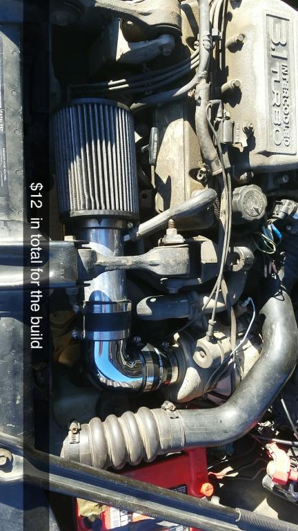

Canada4g63 Posted October 4, 2017 Report Posted October 4, 2017 Built this today. Still waiting on my starter to get here so i can hear it. Psych0matt 1 Quote
Dark Ride Posted October 5, 2017 Report Posted October 5, 2017 That works, although a lot of folks put the air filter directly on the turbo or turn it down so it isn't behind the radiator. Looks good though. Quote
Canada4g63 Posted October 5, 2017 Author Report Posted October 5, 2017 When i get a chance I'm going to make a fmic and delete the a/c and move the radiator over flow jug Quote
Dark Ride Posted October 5, 2017 Report Posted October 5, 2017 That'll be sweet. I like a.c. too much myself to delete it, but a big fmic will help a lot. Quote
Nas Escobar Posted October 9, 2017 Report Posted October 9, 2017 Not bad. Pulls hot air from the engine and rad but it's an A for effort. Quote

Imp558 Posted October 9, 2017 Report Posted October 9, 2017 Given the cost effectiveness and improved surface area of the filter it's good. The big challenge is getting cool air in by locating the filter in an area that's away from things like exhaust manifolds, that's what Nas meant. Bringing cool air in is free power. It's easy to get defensive when you put a lot of work into something but your overreaction was wildly inappropriate here. Grandprix1 and Psych0matt 2 Quote
Grandprix1 Posted October 9, 2017 Report Posted October 9, 2017 I wonder if you could find some way to fab up a heat shield to put around it? Might help your IATs a little bit. Like every one else said the cooler the air the more fuel being put with it which means more power. Noticeable probably not but the engine will like it. Shouldn’t be to hard to fab up a heat shield Sent from my iPhone using Tapatalk Quote
Imp558 Posted October 9, 2017 Report Posted October 9, 2017 There's a lot more than just a/f ratio based on air density but you're right about that being a factor. Cool air is denser and more air in means more expansion when it gets hot inside the engine. i love the filter selection on this project, mine is a monster oem off the shelf filter too. Also looks like it wouldn't be hard to replace, overall this is a very simple and elegant design. Grandprix1 1 Quote

dogginred90 Posted October 11, 2017 Report Posted October 11, 2017 It looks good and that's where the factory had it, but it was enclosed by the factory for a few reasons. And heat was one of them. Take it from a guy who has had 2 TGP motors. I put my filter right on the turbo. It's away from anything heat related per say. And no mine isn't a 10 second car, but it is a high 12 car. Guys on here have been around these cars since they was new(me included) so they have some very good advice. No need to get butt hurt over a few very informative comments. Quote

mfewtrail Posted November 1, 2017 Report Posted November 1, 2017 When i get a chance I'm going to make a fmic and delete the a/c and move the radiator over flow jug Another option for the overflow jug is to go with the 1991-1993 style. It will sit on the passenger side of the engine bay where the large black plastic cover is now. Here's a picture as an example: https://i.ytimg.com/vi/57yqu5_CoG8/hqdefault.jpg If you're going to install a fmic, I would also relocate the battery to the trunk and run that filter over into the fender or build an enclosure to house it where the battery sits now. That would make it a cold air intake and let the car make power more consistently. I've been meaning to do this forever on my cars, but haven't gotten around to it. Quote
