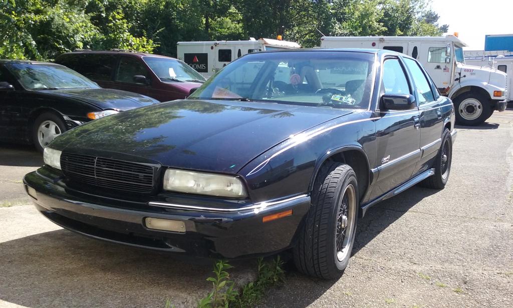

Imp558 Posted September 16, 2017 Report Posted September 16, 2017 These are Yoko Envigor tires in a 225/60/16 and this is the saddest picture I have of this car. Quote
