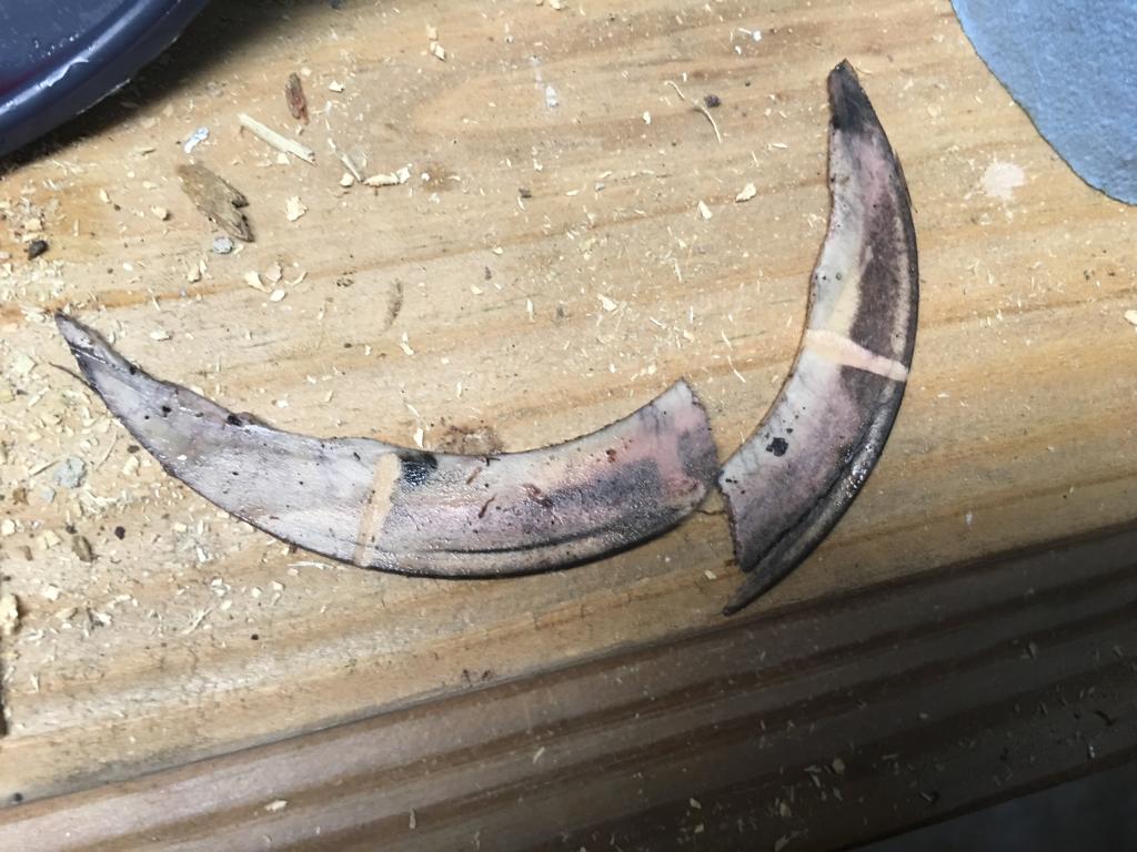

NCTyphoonKid Posted August 29, 2017 Author Report Posted August 29, 2017 Unfortunately 4th gear doesn't work at all, I found this in the trans pan. I got the cradle dropped enough to where I can access the transmission stuff and get it out hopefully 92Lumi 1 Quote

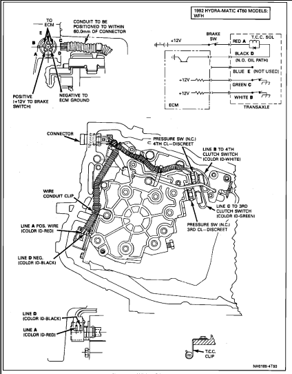

Imp558 Posted August 29, 2017 Report Posted August 29, 2017 What is the parts car you have? I can look in alldata and see if that tranny is the same for you. 92Lumi 1 Quote

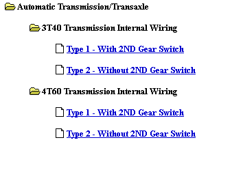

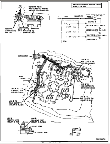

Imp558 Posted August 29, 2017 Report Posted August 29, 2017 I'll get some Prince up for you tonight to look at. It appears as though there were two different versions of the 4T60 in that year. Quote
NCTyphoonKid Posted August 29, 2017 Author Report Posted August 29, 2017 I'll get some Prince up for you tonight to look at. It appears as though there were two different versions of the 4T60 in that year. For 92 or 94? Quote
Imp558 Posted August 29, 2017 Report Posted August 29, 2017 two versions in 1992 looks like the second gear switch. 92Lumi 1 Quote

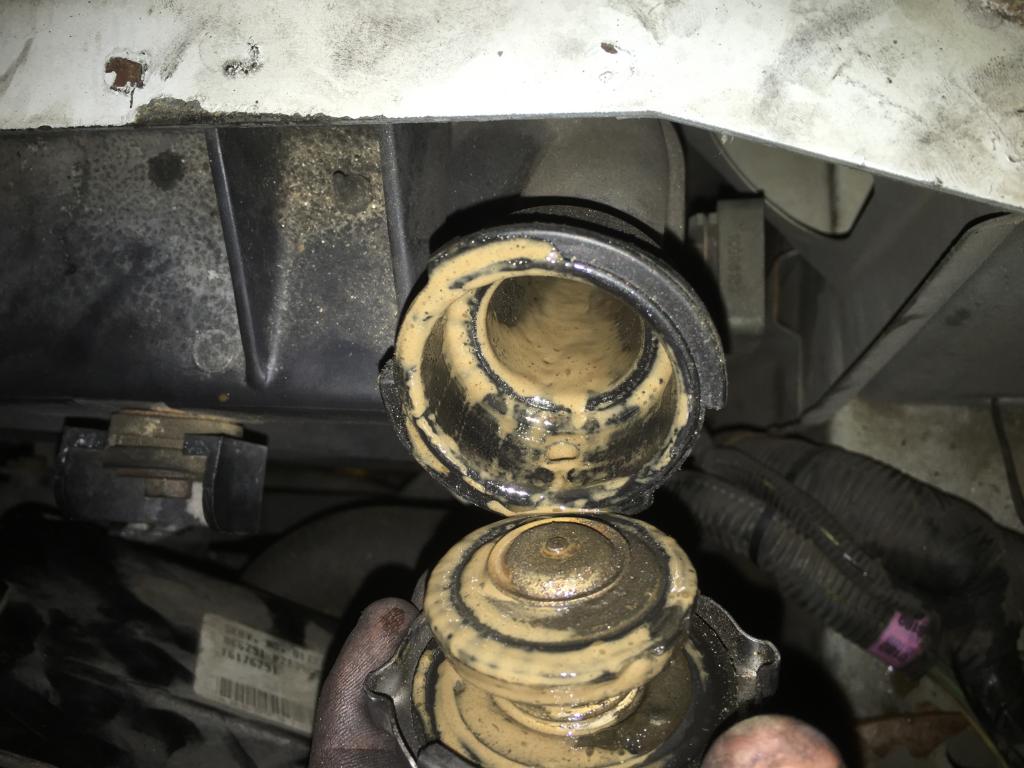

NCTyphoonKid Posted August 30, 2017 Author Report Posted August 30, 2017 Found this when getting all the hoses undone for the cradle drop... joy I didn't want this kind of milkshake Quote
Imp558 Posted August 30, 2017 Report Posted August 30, 2017 The 2 revisions are with or without the 2nd gear switch 1994 4L60-E is very different. With the discovery inside the radiator in mind perhaps swap the entire 1994 powertrain? 92Lumi 1 Quote
NCTyphoonKid Posted August 30, 2017 Author Report Posted August 30, 2017 How hard do you think it would be to swap the 3100 sfi into this? It has everything I can put a battery in it and drive it to my house from my moms Quote
Imp558 Posted August 30, 2017 Report Posted August 30, 2017 Probably have to swap quite a bit in. I can see things like instrumentation and ABS being a hurdle. I've never been waist deep into a really early one like that, maybe one of the other guys will bring some more info in. Quote

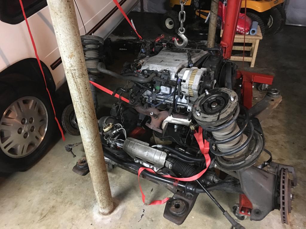

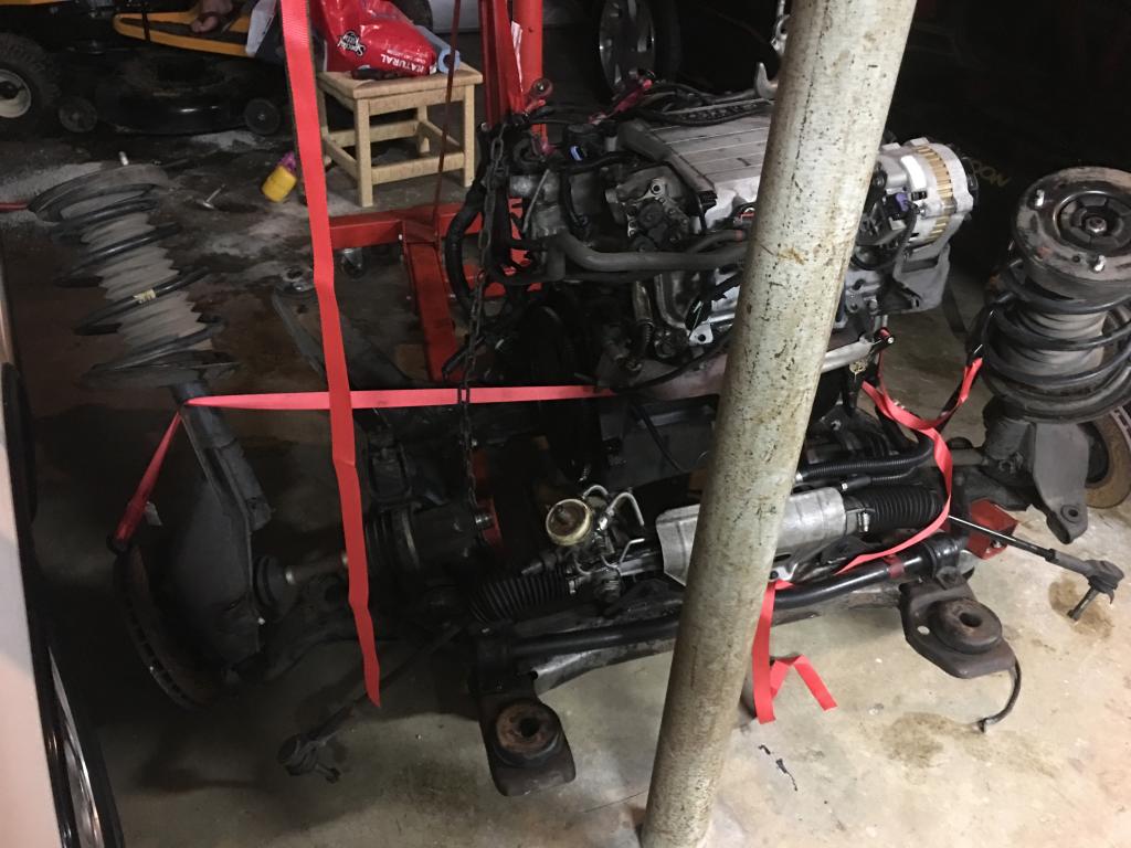

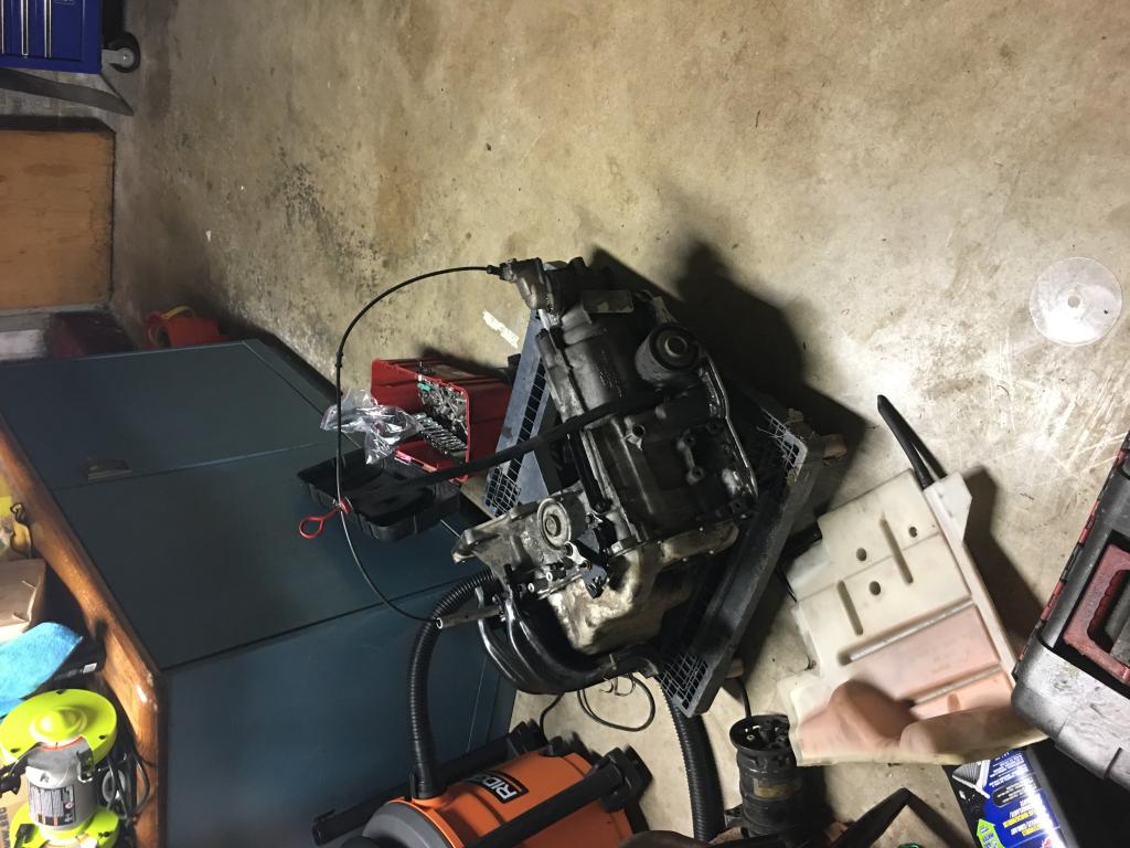

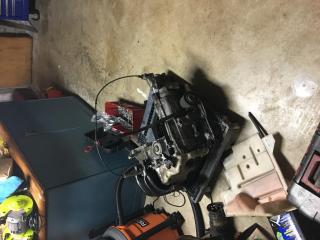

NCTyphoonKid Posted August 31, 2017 Author Report Posted August 31, 2017 Been making good progress got the engine and trans separated and the transmission out on a dolly. Plan on pulling the upper intake maybe tomorrow and see how the gaskets look. If all goes well maybe I'll paint the plenum and valve covers to dress them up a tad 92Lumi and Imp558 2 Quote

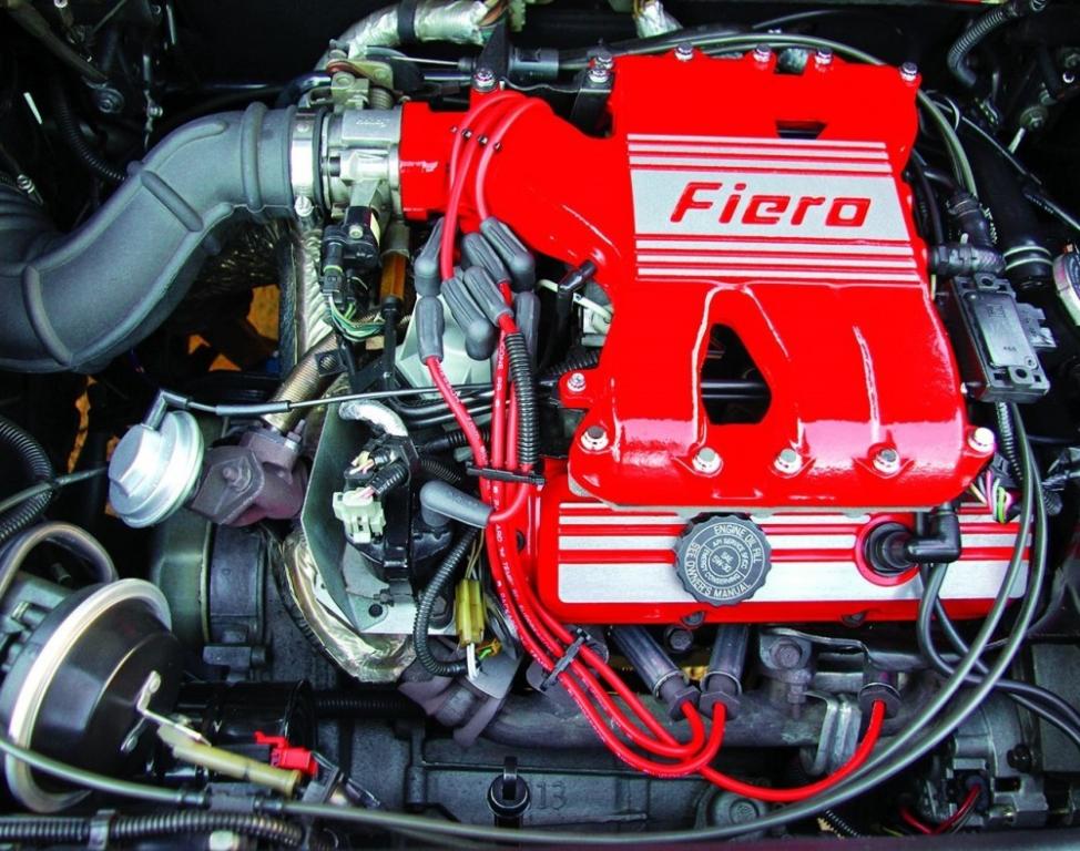

NCTyphoonKid Posted August 31, 2017 Author Report Posted August 31, 2017 Cool pics, want to do that to my Cutlass someday. Make it look factory fresh! There's nothing like a clean engine, this thing has been covered in grease from where it's never been cleaned although that may be a good thing knowing it hasn't really been boogered with by previous owners/shops. I think I'm going to do the plenum and valve covers red and polish the aluminum fins . I think it would go good with the white. Something similar to the stock fiero 2.8 look 92Lumi 1 Quote
