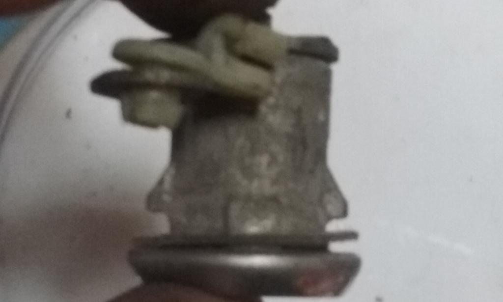

Imp558 Posted August 24, 2017 Report Posted August 24, 2017 this is a door lock cylinder that I had laying around. You should have something almost identical to this, this is the same basic idea every trunk lock cylinder I've ever changed has been. In the picture you can see the barbs on either side, what you're looking for is a clip that appears to be made out of sheet metal and it should be black. it will be catching those barbs once you get into it you'll see Quote
jiggity76 Posted August 24, 2017 Author Report Posted August 24, 2017 Thanks for the picture, really awesome that you did that. I'll let you know how it all goes down. My 91 car is bad but the 89 car has a good one. Only way I can get into the trunk is by using the power trunk release. Be nice to be able to use the key. Did you find a Regal? Quote
