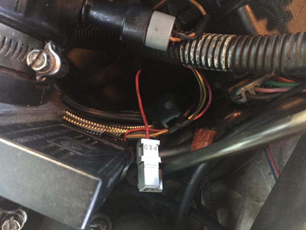

95whitevert Posted May 16, 2017 Report Posted May 16, 2017 Grrr, so I notice after I finished up topping off the Freon (getting to need the a/c now) that I might have pulled out a connector. It is connector PED 19 and for the life of me, I can't seem to figure out where it goes. The MAS connectors look right, so I am not sure where this goes. I have the 3.4l engine. Any help would be appreciated. Quote
95whitevert Posted May 16, 2017 Author Report Posted May 16, 2017 See attached picture. The connector comes out of the wires containing MAS and air intake connectors so my guess it has something to do with the air intake system. Quote
Imp558 Posted May 16, 2017 Report Posted May 16, 2017 That was already loose, it's a fuel pump prime connector. Check continuity to the pins beneath the fuel pump relay to verify but I'm like 99% sure. 95whitevert 1 Quote
rich_e777 Posted May 16, 2017 Report Posted May 16, 2017 Yup its suppose to be loose. Its like that on both my Olds. Your good. 95whitevert 1 Quote

Imp558 Posted May 17, 2017 Report Posted May 17, 2017 If you power it up the fuel pump will come on.It goes to the normally closed terminal on the relay. Quote
