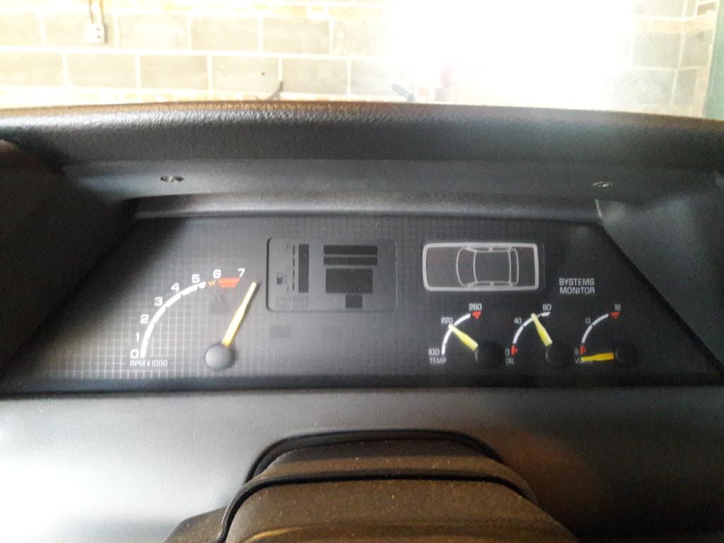

R Crusoe Posted February 6, 2017 Author Report Posted February 6, 2017 I believe the RPM readout is accurate. All the other gauges seem to be working OK but when the ignition is turned off, some of the gauges have a readout, Quote

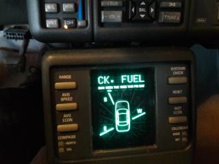

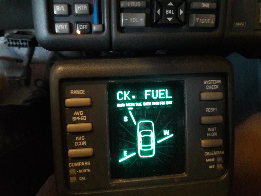

R Crusoe Posted February 6, 2017 Author Report Posted February 6, 2017 -- The first image is the instrument cluster after car has been sitting for a while. It shows readings on the tach, the temp and the oil pressure gauges but the engine is off. The second image is the DIC display showing the check fuel even with a full tank. Quote

55trucker Posted February 7, 2017 Report Posted February 7, 2017 The second image is the DIC display showing the check fuel even with a full tank. How long have you owned that vehicle? That photo of that DIC display is a '91 or later DIC, the 88-90 DIC is the older design. I'm going to assume that someone has installed that into your car . https://i.ytimg.com/vi/Ghjwxmx22X4/maxresdefault.jpg R Crusoe and Heartbeat1991 2 Quote
Padgett Posted February 7, 2017 Report Posted February 7, 2017 Have seen gauges do that when a ground is bad. Floating ground could cause everything. I'd just try running a jumper wire from a hard engine ground to the dash shell and see if things change. Quote
R Crusoe Posted February 7, 2017 Author Report Posted February 7, 2017 I have owned the car since new in 1989. DIC is what was there when the car was delivered new. Bought it in California, moved to Illinois with it driving cross country and then to Florida. Now back in Illinois where car is garaged and waiting to sort out small but agrivating issues before re-registering it again. Engine running well after replacing stock fuel injectors. Quote

RobertISaar Posted February 7, 2017 Report Posted February 7, 2017 drain/cluster partially lit makes me think you may have an ignition switch issue as well. Quote

R Crusoe Posted February 7, 2017 Author Report Posted February 7, 2017 The first image of the instrument cluster with the gauges showing readings is with the ignition off and no key in the ignition. When the ignition is on, the instrument panel lights up completely . Quote
55trucker Posted February 7, 2017 Report Posted February 7, 2017 Is replacing ignition switch a big deal? Could I do it myself? The switch is located on the topside of the steering column approx half way down. It is connected to the key tumbler via a length of hard wire that moves back & forth to open/close the switch contacts as you turn the key. It's not terribly difficult to get at, remove the plastic shield under the dash, drop the driver's side knee pad, unfasten the bolts that hold up the column, it will fall onto the seat, you can now see the switch assembly. If the switch is the source you can disconnect the harness from the switch and observe if the issue goes away. I'm still puzzled by the later VFD display DIC in an '89 vehicle instead of the LCD. ....with the key on & when you open either the left or right door does that show up in the DIC display as well? Heartbeat1991 1 Quote
Psych0matt Posted February 7, 2017 Report Posted February 7, 2017 I'm still puzzled by the later VFD display DIC in an '89 vehicle instead of the LCD. Same. Perhaps it's a very late production 89 and some got the updated DIC? Heartbeat1991 1 Quote

Heartbeat1991 Posted February 22, 2017 Report Posted February 22, 2017 Same. Perhaps it's a very late production 89 and some got the updated DIC? How late production? Those DICs didn't come out until 2 years later. LOL Imp558 1 Quote
Nas Escobar Posted February 23, 2017 Report Posted February 23, 2017 How late production? Those DICs didn't come out until 2 years later. LOL Late that it sat at a dealer for 2 years and the dealer upgraded it. Hahahaha Quote
digitaloutsider Posted February 25, 2017 Report Posted February 25, 2017 How late production? Those DICs didn't come out until 2 years later. LOL Technically they came out the very next year in the STE (1990). Either way, it didn't come in that car originally. Could have been a warranty replacement at some point. Quote
