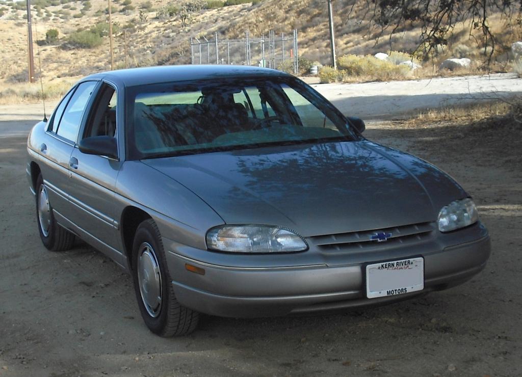

1979lee Posted December 3, 2016 Report Posted December 3, 2016 hey guys' its time for new front brakes. and i'd like to find something better then the stock pads. This car has never stopped that good.(everythings in order and working) but it just dosent stop that good. I looked up the MSP Michican state police repot for my 97 and it says 60-0 stop in 165 feet! WOW IS THAT BAD!!, the same year crown vic stopped in like 135 ft... My car Is a No ABS car, maybe thats the problem?? anyhoo. y'all got a recomendation for better pads? something i can buy at say autozone or orileys, pepboys carquest,napa.??? thanks folks. Quote
