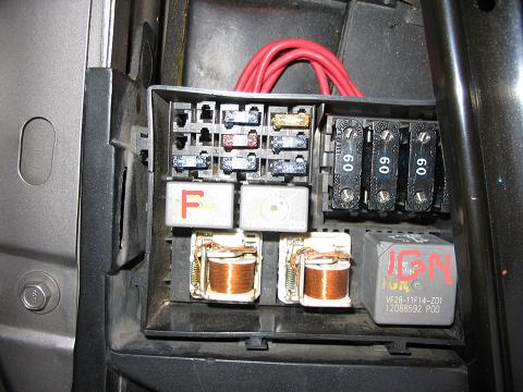

ron350 Posted November 9, 2016 Report Posted November 9, 2016 When my 96 Regal was apart for a long time i was told to pull the Ignition Relay and the Fuel Pump relay. Then spin the motor over a few times to build oil pressure before reinstalling the relays. Quote
95GS Posted November 10, 2016 Author Report Posted November 10, 2016 Imp, I like the manual cranking suggestion for a very long storage period. Pulling the ignition & fuel pump relays makes good sense. On your 96, are these under the hood on a fender? Same box or different locations? Thanks, my Haynes is some hours away. Quote

ron350 Posted November 10, 2016 Report Posted November 10, 2016 The relays are under the hood up against the passenger side fender. Quote

95GS Posted November 11, 2016 Author Report Posted November 11, 2016 Leave for a day, answers flood in! Good info all, thanks Ron for the photo. Crank and drive will no doubt work. I'd not heard of filling the filter, but see the logic. Do these tweaks & primps make a difference? Maybe they're measureable one-percenters which add up over time. Remnant oil in the crank & cam journals might suffice for lube carry over, so fresh gas on un-lubed cylinder walls would be the weakest point (think I read a study on this long ago..). Prudent attention to detail is an overall asset in car maintenance and in life. While it's possible to obsess compulsively, most people tend not to care & would not manage well with a 20 y.o. car. Yes, the Buick oil filter (angled) is difficult to access. My normal concern upon installation is getting grunge in the new filter or on the oiled gasket. I drain the oil when the engine is hot, let it drip for several hours while I do something else. Use the slope of the property to angle towards the drain hole, both front wheels driven up on wooden boards (3-4" elevation), rear wheels chocked, steering wheel cranked hard left to give me filter access. No jacking. Quote
