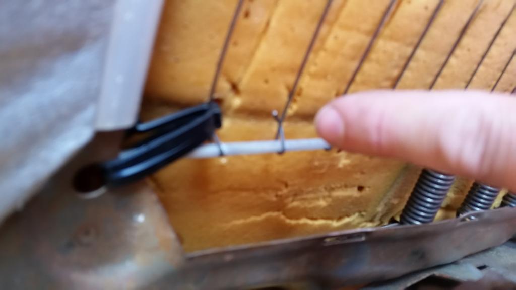

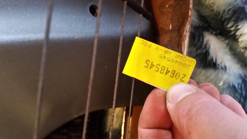

W30olds Posted October 7, 2016 Report Posted October 7, 2016 After 20 years of use my drivers seat cushion was gone. When I got home from work today I decided to fix it. The passengers side is like new, so I swapped the cushions. Once I figured out how to get the cushion off the seat frame I noticed what had failed. The springs frame had broken in the front and had chewed up the foam padding. Well after some thinking I used some heavy duty zip ties and repaired the broken supports and secured them back to the seat frame. I used the passenger side cushion as a replacement. Put it all back together and back in the car. Now the drivers seat feels like new. No more poking me in the ass! I also found the interior tag still on the passenger seat with the seat code. Now I'm looking for a replacement seat with a good cushion for the passenger seat. Found a few on carparts.com and waiting to hear back from several places. Hopefully I will find a matching seat soon. I took a few pics which I will try and post. All in all the fix wasn't that hard once I figured how the seats came apart. Imp558 1 Quote

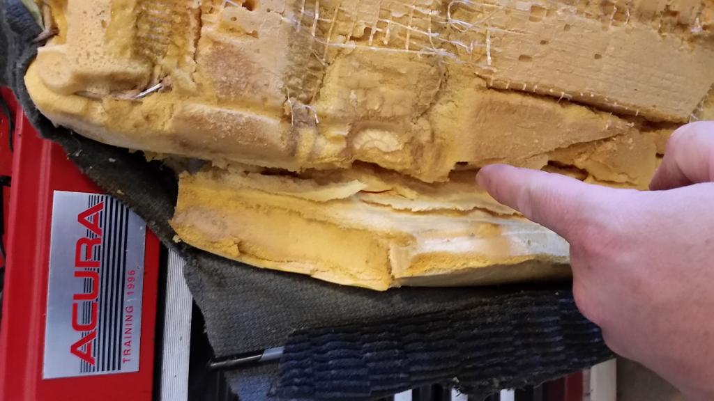

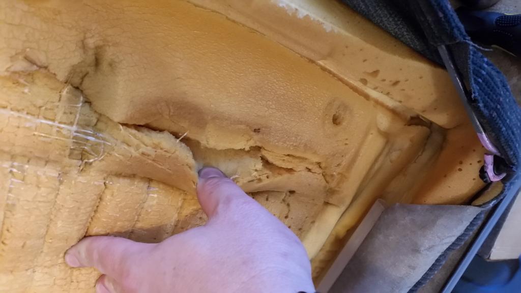

W30olds Posted October 7, 2016 Author Report Posted October 7, 2016 As you can see the cushion is done. It's completely chewed up and torn. No wonder I had springs digging into my ass while driving. Quote
