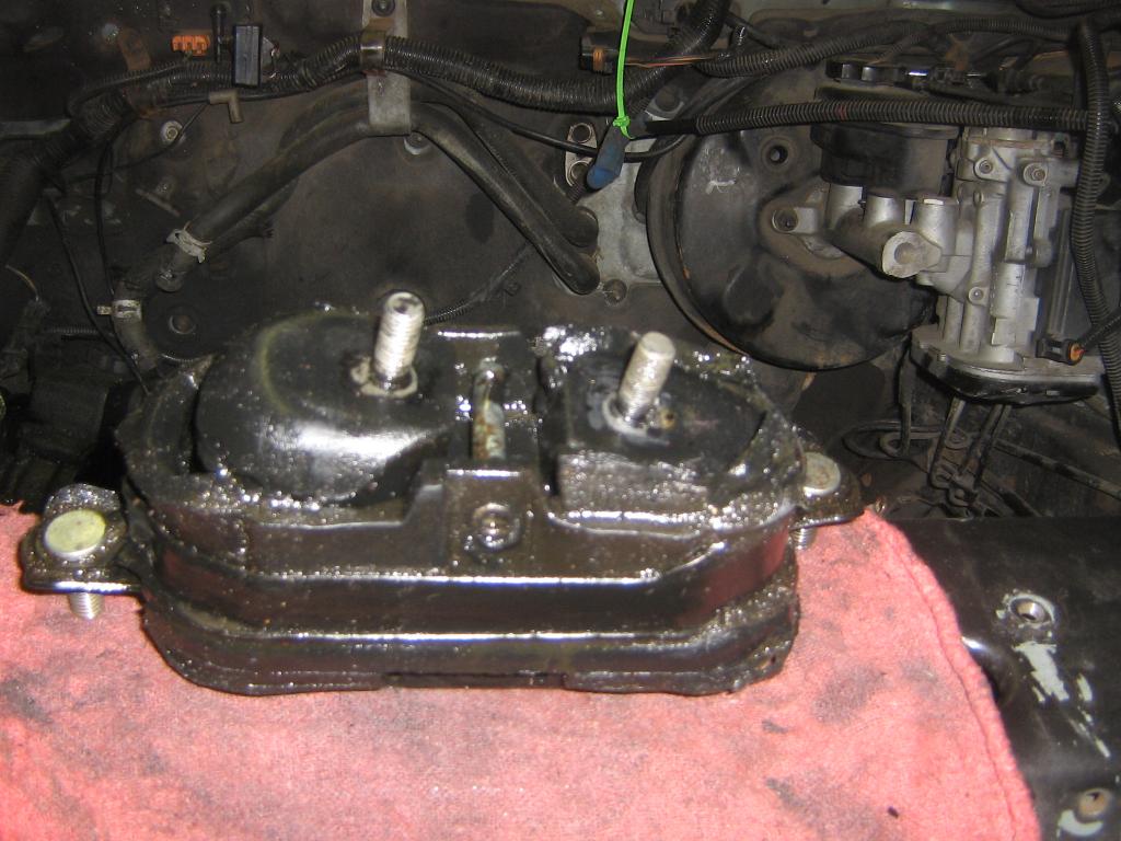

2001goldGTP Posted February 21, 2017 Author Report Posted February 21, 2017 So sorry this took forever, new house got to me and I did not need to daily drive the Cutlass for a while so I sort of did the bad thing and didn't get around to it. I did my best to remove it the book way, remove the bracket from the engine with the mount then remove the mount. I soaked the bolts in penetrating fluid for days, took my impact gun to them and basically broke an impact socket without the bolts budging. So I gave up and did all I could to get at them with a wrench or socket. After talking it out with a friend we came to the conclusion to go get and possibly modify a high offset wrench to make it work. We took my socket that cleared but the bracket only without a wrench to know if the idea was even possible. Bought the harbor freight cheapos because I thought I was going to need to take a torch to them and behold the harbor freight wrenches fit without modification and the ugliest motor mount came free.... primergray 1 Quote
Imp558 Posted February 21, 2017 Report Posted February 21, 2017 That still looks fine 2001goldGTP, RobertISaar and Psych0matt 3 Quote
Imp558 Posted February 26, 2017 Report Posted February 26, 2017 I was just looking for some files and I found this picture. Mine wasn't quite as awesome as yours. From what I understand this is what a typical failed one looks like. Quote
2001goldGTP Posted February 26, 2017 Author Report Posted February 26, 2017 There is "failed" and then there is got every penny out of it lol Imp558 1 Quote
