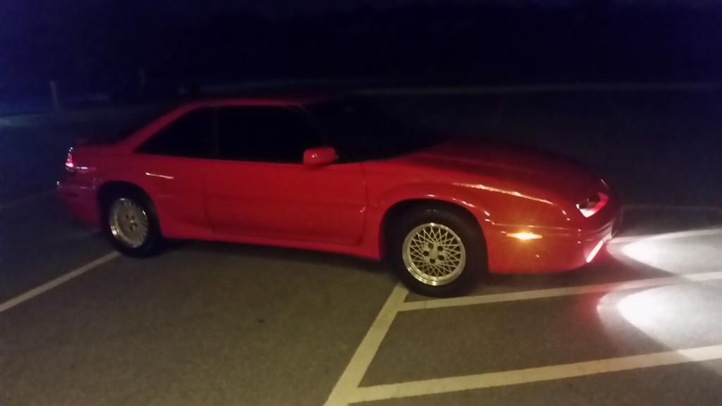

W30olds Posted July 31, 2016 Author Report Posted July 31, 2016 Here is a night time shot. Was out driving through some twisty roads rich_e777, primergray and Imp558 3 Quote
