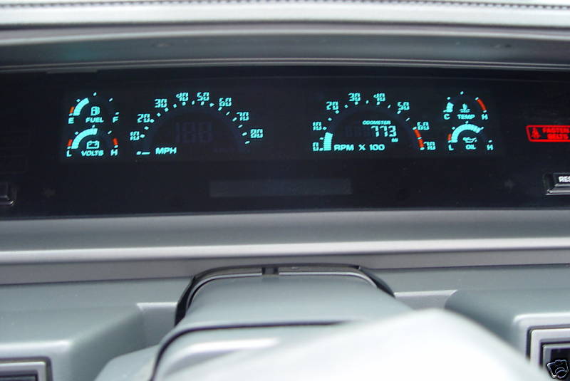

ManicMechanic Posted July 30, 2016 Report Posted July 30, 2016 On 1988-1991 HUD equipped cars, the speedometer only uses the bar graph, not the numeral readouts. So perhaps they thought it all had to be serviced together. Quote
94 olds vert Posted July 30, 2016 Report Posted July 30, 2016 My car has a UB3 from a 88-91 HUD car. Not digital readout for the speed. Quote
ManicMechanic Posted July 30, 2016 Report Posted July 30, 2016 I think it's cool but I would rather have the readout. That way if a cop pulls you over for speeding you can say you have THREE speedometers and no way that was possible. hah! Quote
jiggity76 Posted July 30, 2016 Author Report Posted July 30, 2016 I have a spare cluster from a non HUD car. Could I switch it out and have the three readouts then! That would be cool! Quote
jiggity76 Posted July 30, 2016 Author Report Posted July 30, 2016 Oh wait, I remember someone saying that the 3.4 DOHC cars had a different redline tach that the smaller engine cars so maybe I'll just leave it alone. Quote
ManicMechanic Posted July 30, 2016 Report Posted July 30, 2016 Oh wait, I remember someone saying that the 3.4 DOHC cars had a different redline tach that the smaller engine cars so maybe I'll just leave it alone. GnatGoSplat got a readout working fairly simply from what I understand. Quote
jiggity76 Posted July 30, 2016 Author Report Posted July 30, 2016 If I remember, I think that my car does show the digital speedometer even with the HUD. The hood cable is busted and the battery is bad so can't look at it right now. I've seen a couple of pics that show cars with HUD and the digital speedometer too so not sure. Once I get the hood open and drop in a battery I'll let ya guys know. Quote
GnatGoSplat Posted July 30, 2016 Report Posted July 30, 2016 Redline on the Cutlass UB3 is real simple. It comes from the ALDL so it'll always be correct. The digital readout on a HUD cluster isn't very easy to enable. I had to solder a ton of tiny wires because there are no traces connected to the digits. The electronics are there, but wire traces absent from PCB. Can post pics when I get home. Imp558 and Nas Escobar 2 Quote
Luke94vert Posted August 1, 2016 Report Posted August 1, 2016 The 88-91 ub3 digital read outs were only shown if the car was a non-HUD. HUD equipped ones did not have a digital number readout in the cluster. Quote
