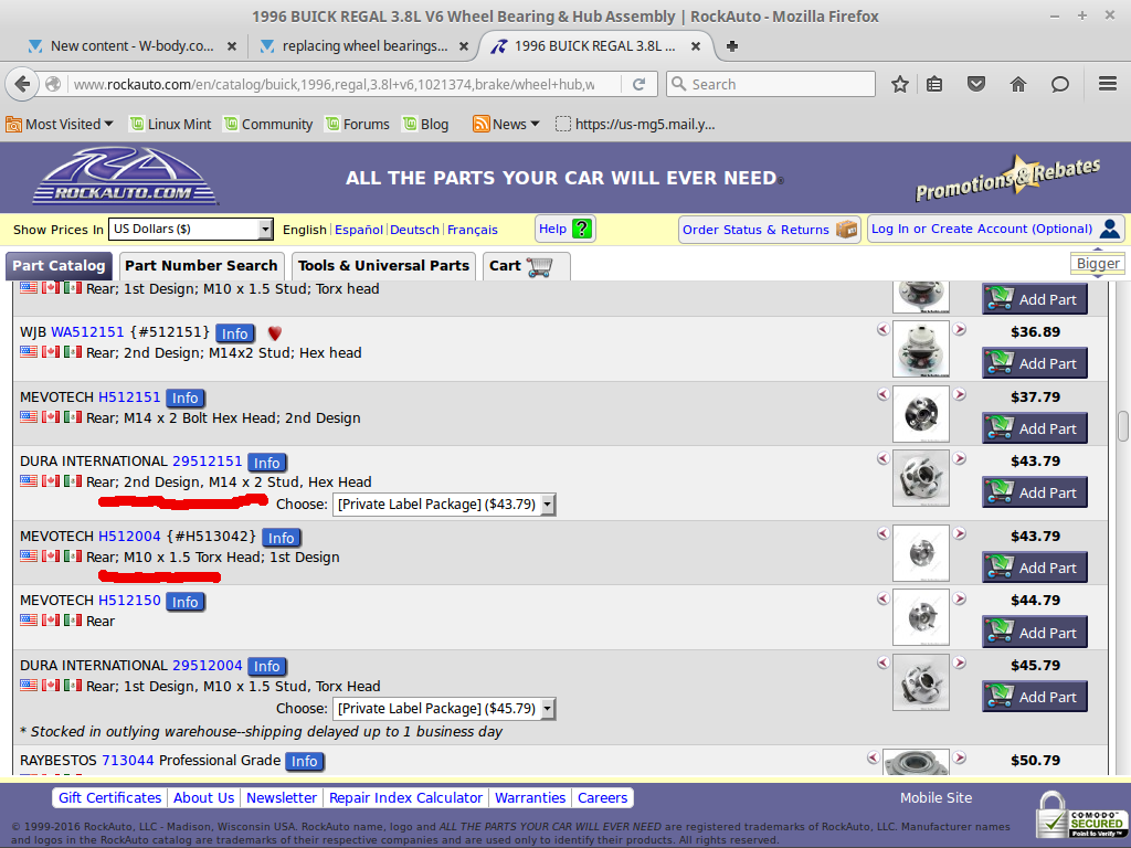

Imp558 Posted July 22, 2016 Report Posted July 22, 2016 I forgot about this thread... or ... tried to, but now that I see it again it's also good to point out that there were 2 different hole sizes in the wheel bearing assemblies. If you use the small bolts in the one that was intended for the large ones they don't catch much metal. In which case I suppose you may as well forego the proper torquing too because it's already terribly frightening and there's not a hell of a lot more that can go wrong at that point. Quote
worb4me Posted August 1, 2016 Author Report Posted August 1, 2016 Which bolt holes are we talking about? If you're suggesting being somewhat off regatding torque represents the same danger as bearing mounting bolts giving out, well, I just have to scratch my head. If I understand you even. More specifics would be helpful, and I do appreciate your input believe me. Quote
Imp558 Posted August 2, 2016 Report Posted August 2, 2016 when you purchase a hub assembly the hub assembly is available with two different hole sizes 2 mount to the spindle. Quote
Nas Escobar Posted August 3, 2016 Report Posted August 3, 2016 when you purchase a hub assembly the hub assembly is available with two different hole sizes 2 mount to the spindle. On a first gen? Psych0matt 1 Quote
Imp558 Posted August 3, 2016 Report Posted August 3, 2016 On a first gen? Yes I think one is 10 millimeter and the other is a 14 millimeter don't hold me to that I'm just pulling from my very very bad memory. Rich works at AutoZone he should know what I'm talking about. Quote
Nas Escobar Posted August 3, 2016 Report Posted August 3, 2016 Yes I think one is 10 millimeter and the other is a 14 millimeter don't hold me to that I'm just pulling from my very very bad memory. Rich works at AutoZone he should know what I'm talking about. What year did they make this change? My 94 is all 13 (or 14, can't recall for sure). Quote
Psych0matt Posted August 4, 2016 Report Posted August 4, 2016 What year did they make this change? My 94 is all 13 (or 14, can't recall for sure).thats what I was thinking Quote
Imp558 Posted August 4, 2016 Report Posted August 4, 2016 It's the rear hub assemblies I'm remembering, and somehow I even remembered the bolt sizes correctly. Quote
