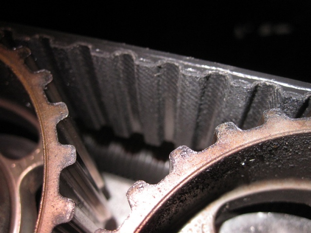

Bigdaddy000 Posted April 24, 2016 Report Posted April 24, 2016 I just replaced the HG and TB less than 1000 miles ago. Well driving home last night my car died about 10 miles from home. It's a 94 Cutty vert with the 3.4 DOHC engine. I mean it just ..boom..died. I have plenty of spark and fuel so i'm thinking let me look and see if the belt jumped. OMG..look at this shit. Quote

Bigdaddy000 Posted April 24, 2016 Author Report Posted April 24, 2016 Im just wondering, what would cause the belt to meander towards the block? All the idler and tension pulleys were new and still have no play in them. Also the idlers, are they side specific? Quote
Imp558 Posted April 24, 2016 Report Posted April 24, 2016 I had the same thing happen to me. Make sure to change all the timing pulleys when you change that belt. Im just wondering, what would cause the belt to meander towards the block? All the idler and tension pulleys were new and still have no play in them. Also the idlers, are they side specific? I've never done one, but I'm guessing that's why Nas said to change the pulleys Quote
Galaxie500XL Posted April 25, 2016 Report Posted April 25, 2016 My first timing belt failure was caused by one of the idler pulley bearings failing, heating up, and melting the plastic pulley. The previous owner apparently decided to replace only the belt. As a result, both belt replacements I did, EVERYTHING was replaced. I suspect what has caused what I see in the picture is a hydraulic actuator failure. rich_e777 and Bigdaddy000 2 Quote

Schurkey Posted April 26, 2016 Report Posted April 26, 2016 Thousands of years ago, when I was having the Stealership do my Lumina work, they called me over and explained that the edge of the timing belt was frayed similar to the photo above--but not as bad. Mine was only torn-up about 3/8". The Stealership blamed this on faulty pulleys, since they weren't replaced at the previous timing-belt change. I had to pay for replacing a < 20K timing belt. About a week later, I found my previous receipt from this same dealership, showing that I was charged for a timing belt "kit" that included the pulleys. By then, I had already paid, and they weren't inclined to provide a refund. Since I didn't see the defective pulleys that caused the edge of the belt to fray, I can't say for sure that the pulleys were bad, or if there was some other cause. It's still a mystery to me. That dealership doesn't work on my vehicles, and hasn't for a decade or more. Imp558 1 Quote
Galaxie500XL Posted April 26, 2016 Report Posted April 26, 2016 Even replacing everything isn't always a guarantee that things stay fixed. My second belt replacement came only 30,000 miles after my first replacement, when the brand new hydraulic actuator ($130.00) failed, causing tension to be lost to the belts. Even more surprising, the actuator failed while cruising at around 35 mph...I wasn't even driving it hard when it died. Bigdaddy000 1 Quote

Bigdaddy000 Posted May 1, 2016 Author Report Posted May 1, 2016 Galaxy500, you hit it on the head. The actuator was not in the cup and that's my fault. I don't remember doing the procedure I did yesterday. Anyways, all new pulleys and belt so life is good again. Thank goodness it's a non interference engine because that would've SUCKED. Heartbeat1991 and Galaxie500XL 2 Quote
