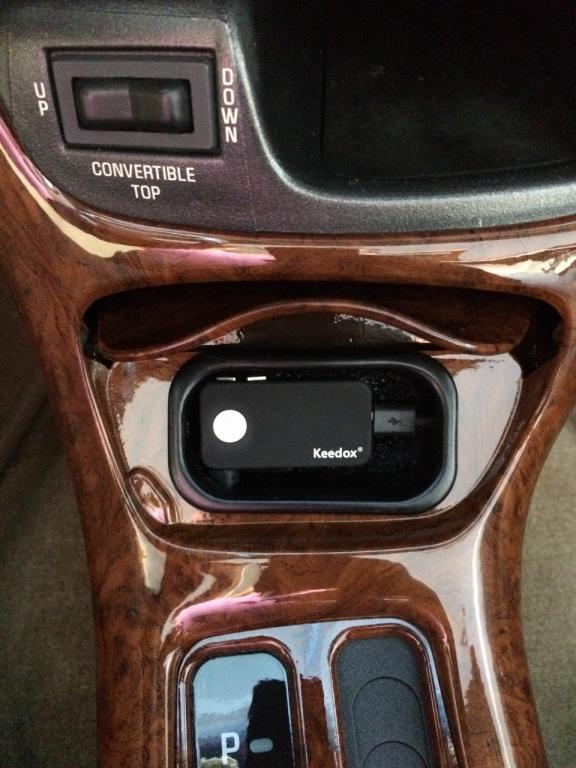

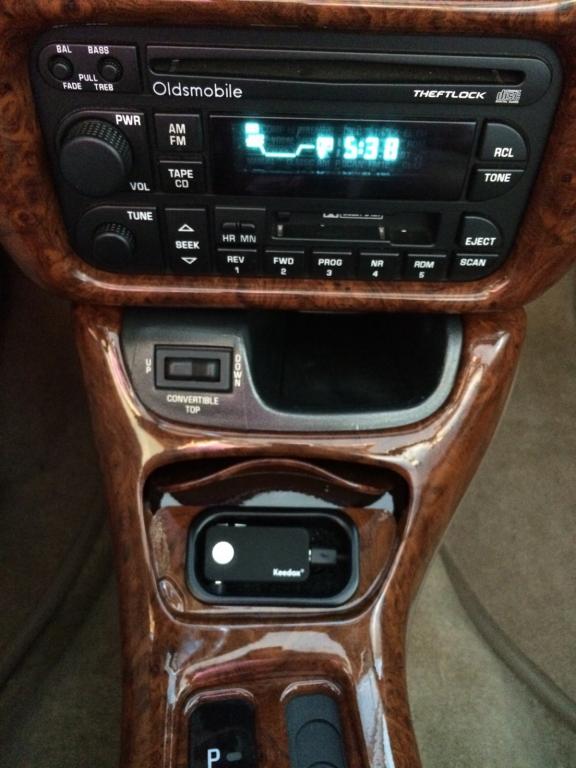

MemphisMan Posted April 4, 2016 Report Posted April 4, 2016 Since I've had the car I've used a cassette adapter hooked to my iPhone in order to stream music. It was a nice simple solution which allowed me to keep my car stock. I was satisfied with the sound quality, but I never liked the cord sticking out from the head unit. I don't like exposed cords in general, so I've been trying to figure out a way to hide the cords and utilize bluetooth. I came up with the following solution which hides all of my cords, including the charging cord for my iPhone. The bluetooth device is here: http://www.amazon.com/Bluetooth-Receiver-Wireless-Streaming-Smartphones/dp/B00UL4F2ZI?ie=UTF8&psc=1&redirect=true&ref_=oh_aui_detailpage_o01_s00 The dual USB power inverter I installed is here: http://www.amazon.com/HitCar-Inverter-Converter-Charger-Recorder/dp/B00OHHT7ZG?ie=UTF8&psc=1&redirect=true&ref_=oh_aui_detailpage_o00_s00 I connected the bt device to my head unit using the same cassette deck adapter I've been using. The difference here is that I removed the head unit then removed the front and bottom plates. I inserted the cassette adapter in backwards so the cord would snake out of the back of the head unit instead of the front. Then I installed the head unit back in and ran the cord under the console and up to the bt device. I put the power inverter inline with the 12v power connection in the passenger foot well. The bt device sits in a spare ashtray I picked up at the salvage yard (because I had to cut two holes in it for the audio cord and the charging cord). Inside the ashtray, the bt device simply sits on a foam pad I cut to fit. It sounds the same as it ever has, but no cords. The extra USB port coming out of the inverter was used to connect a charging cable for my phone which I routed to the center console storage bin. Nice and tidy. You can't even tell there's a cassette adapter in the head unit. 94 olds vert 1 Quote

MemphisMan Posted April 4, 2016 Author Report Posted April 4, 2016 I only had the round 12v adapters too, but I hooked a power inverter inline with one of them so I now have 2 USB ports, one for the bt adapter and one to charge my phone. The power inverter I linked has worked well for the past couple of months. 94 olds vert 1 Quote
