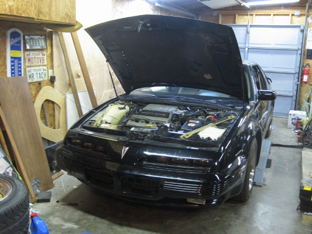

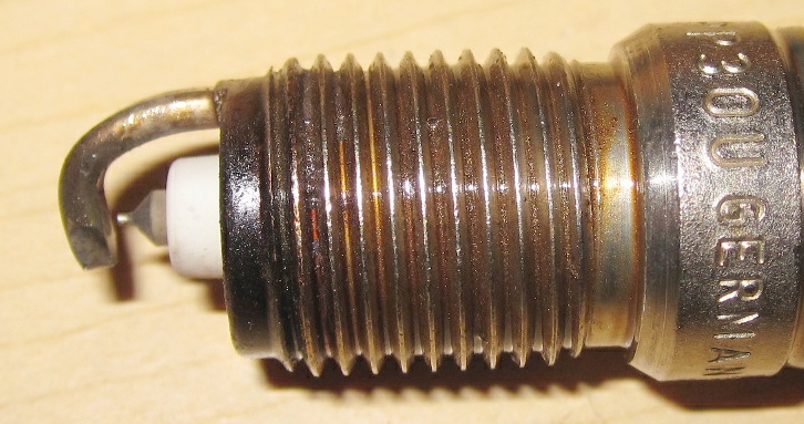

Padgett Posted March 12, 2016 Report Posted March 12, 2016 ever since I bought it. Was OK with occasional misfire and I put the 12 mpg down to excessive idling. That said for me plugs are a part of routine maintenance and I had a bunch of Rapidfire #14s I use in 3800s with Delco ignitions For that application I gap them at .060 (.045 #3s for Magnavox). The LQ1 has the same coils I use in the Reattae so gapped .060 also. So using two screwdrivers as levers to raise the plug sheaths I find that the plugs seem to have been installed by a trunk monkey with an air gun. Took some tapping on a 18" breaker bar to get the front three loose but once loose they spun out clean. Put new ones in with a 3/8 ratchet and about 15 lb-ft torque. 1 & 5 look OK but #3 seems waaay too tight (see pic. ) Is less than .020. Plugs look almost new, just that one is misgapped (dropped ? No sign of hitting something.). Seems to idle a lot better. Which brings up the question of the back bank. Is there a way to change the rear plugs without removing the intake ? Seems like almost enough room to the firewall but not certain what angle the sheaths come out at. Is this possible ? Service manual seems to want you to remove the engine. Advice welcome. ps a magnet on an extension is handy to fish plugs out when your 5/8 plug socket has lost its sponge. Quote

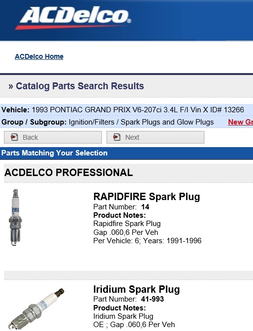

Padgett Posted March 13, 2016 Author Report Posted March 13, 2016 My first LQ1 but have had quite a few 3800s and with the Delco ignition they like .060", is the factory spec but those are 5,000 rpm engines, for 7,000 it may want a tighter gap so could change to .045 which is the LQ1 spec for a R44LTSM (copper core). Anti-seize in an aluminum head is a good idea but these were not seized (threads in photo are clean) just way over torqued but once I got to move at all, they spun freely. Believe me I know what a seized plug in an Aluminum head feels like. BTW a Rapidfire #14 is designed for .060", the #3 is the same plug designed for .045 (I use those with the lower power Magnivox system. Did a review a few years ago. As mentioned have had good luck with 14s and have a few boxes so might as well try. Would go Iridium if I bought any. Appears to have Bosch platinum 6704s. OTOH this is what AC Delco says: rich_e777 1 Quote
Padgett Posted March 13, 2016 Author Report Posted March 13, 2016 Got a plug socket with rubber insert and did the rear bank today. Took dogbone loose and rocked, then pulled weather strip. These were torqued properly so no problem removing. I used a long wobble extension and that helped. Three more Boschs, found five gapped .044 and one .015. Now have six Rapidfire #14 gapped .060 per Delco spec. & personal experience. Light schmear of anti-seize. Idles MUCH smoother and feels like more power/response. Pulls smoothly from 15 mph in third. 94 olds vert 1 Quote

Padgett Posted March 14, 2016 Author Report Posted March 14, 2016 I hear you but as mentioned I've been running 3800s with Delco ignitions (if I get one with a Magnavox I upgrade immediately) with #14s & .060" gaps for over a decade and other than an occasional coil failure (I get the whole ignition: plate, screws, ICM, and coils from the recycling center) have not had a problem. See here. You are correct I would not run this wide with points or a HEI but the LQ1 is a DIS system with AC Delco plug wires. I am a bit concerned about the ICM/Coils location under the header, may build a little air scoop So going to give it a try and see how it feels. This is a different engine for me and in Fiero 2.8s I ran #1s at .045 since they have a distributer. But the Delco ignition here is the same design and coils as the 3800 one. Quote

Padgett Posted March 14, 2016 Author Report Posted March 14, 2016 (edited) Just for S&G, AC Delco recommends the same #14 and .060" gap for the L67 supercharged 3800. Am sure it would run fine with .045 but the place where a fat spark and a big gap makes a difference is in cruise at highway speeds when the mixture is lean. Also almost all of Florida is close to sea level & have no doubt Denver is different. YMMV. That said I make the run down to south Florida quite often and can go 180 miles with a 70 mph limit and no stops (could go over 200 but I stop at Boynton). Just turn on the tunes, set the cruise, and go. Highest point is at the top of the Thomas B. Manuel bridge. Just looked up the plugs for my 2012 Jeep and that calls for a .043-.045 gap. Since it is the closest to the LQ1 (3.6 liter DOHC 24 valve 6 cyl, 10.25:1 cr, 6500 redline - said I have a weakness for a good DOHC 6) the needs should be similar. Only difference is being OBD-II I can monitor misfires on my cell phone, for the GP I need to use an OTC 2000 with a 93 cartridge - suspect a 91 or 92 would also work but have a 93). So if I feel any roughness under high speed load, I'll back them down to .045 but for now, .060 it is. Edited March 14, 2016 by Padgett Quote
Padgett Posted March 26, 2016 Author Report Posted March 26, 2016 Just went to Lakeland and back, occasional hiccough but cruise at 70 was smooth. Turning 2425 rpm at 70 mph, under 2000 is best for economy. AC on MAX and about 5 miles of stop and go around Disney so guess 20.5 MPG average (filled at same pump) for 113 miles is not that bad. Not sure what or if a thermostat is in there, travel out this morning coolant ran 170-174F, coming back with AC on 194-197F. Had a sound at idle when I got to Lakeland like a chain occasionally rattling, not there when I got home. May be first exercise the GTP has gotten in a few years. Quote
