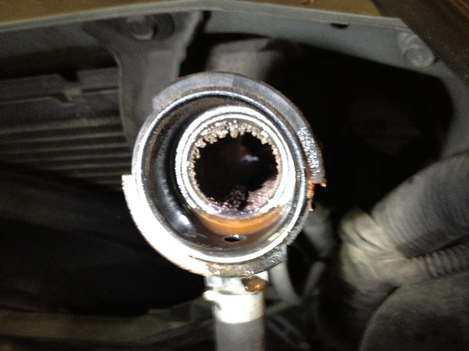

poofdirt Posted August 22, 2012 Report Posted August 22, 2012 (edited) About to post an engine question and have read the rules but not sure how it works here, for example... I have belonged for years to a diesel truck forum that will pummel you about your face and head if you ask a question that was answered in the forum 6.3 years ago. Early last year, I joined a great boating website and they punch you in the gut for robbing a thread by doing what the ^ diesel site does ^ I guess I'll take my chances here. I just bought a 96 Cutlass 3100 and my Mechanic buddy of 30 years said to change the dexcool, stat, water pump and radiator cap right away, so I'm doing all in addition to a fuel filter and serp belt this weekend. He said that the intake manifold gaskets are a problem. It looks like old tired coolant in the res. so what is the issue with the intake gasket? Thanks and this looks like a great forum! Edited August 22, 2012 by poofdirt Quote

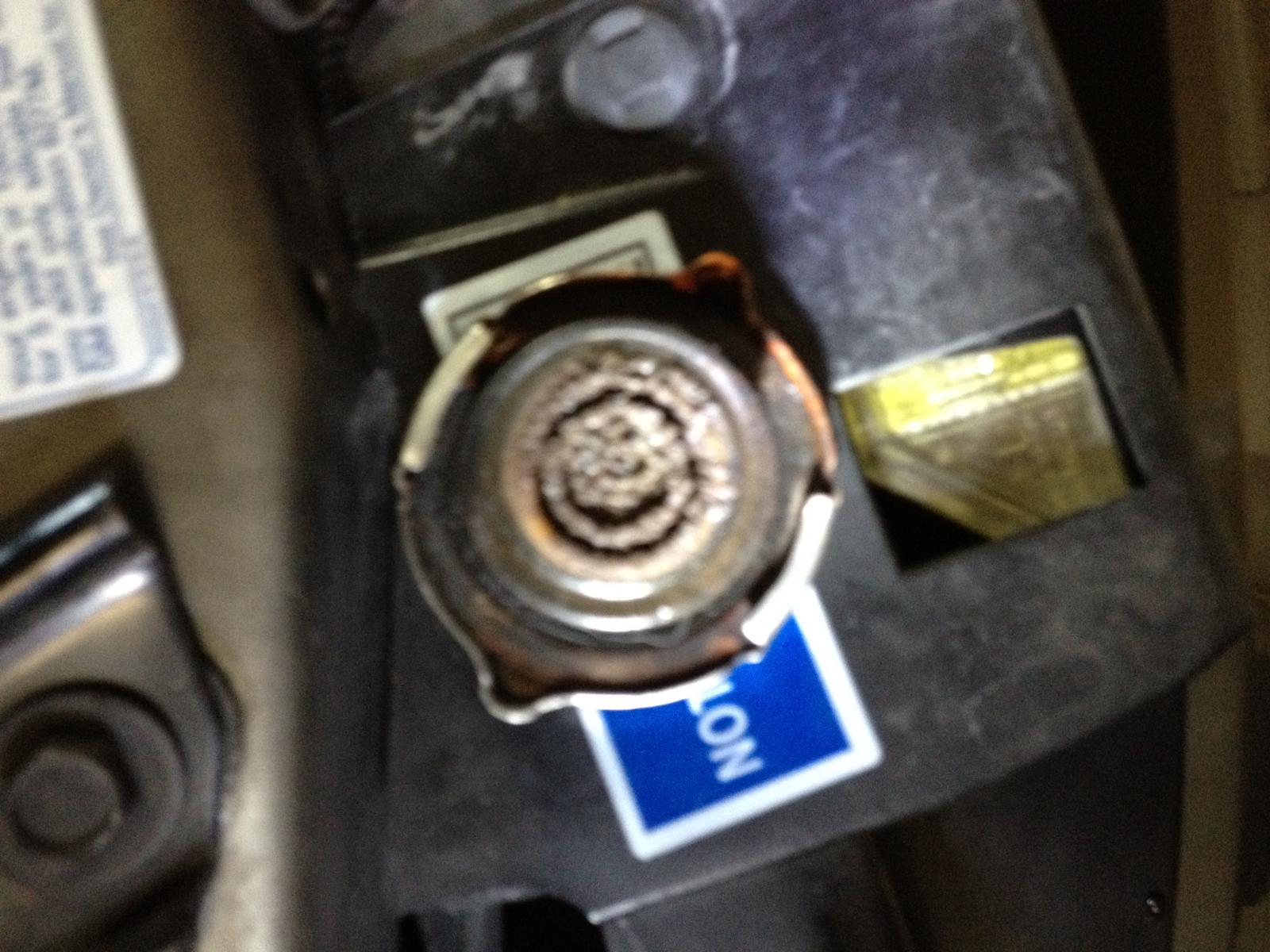

poofdirt Posted August 25, 2012 Author Report Posted August 25, 2012 Nice car, but coolant must be from Olds Plant from build date. Full of CRUD! Have H2O pump, stat, radiator cap, etc. all new on hand but they can wait. Flushed for about an hour thru 4 or 5 stat cycles and I need to flush a couple times more before new parts go in. My wife wants to know why I am replacing a good water pump, is it broke? Quote
RobertISaar Posted August 25, 2012 Report Posted August 25, 2012 sadly, that's a familiar sight to me. if your radiator neck looks like that, imagine what might be stuck in the water pump. Quote
poofdirt Posted August 25, 2012 Author Report Posted August 25, 2012 sadly, that's a familiar sight to me. if your radiator neck looks like that, imagine what might be stuck in the water pump. And the smallest passages like the radiator! Quote
