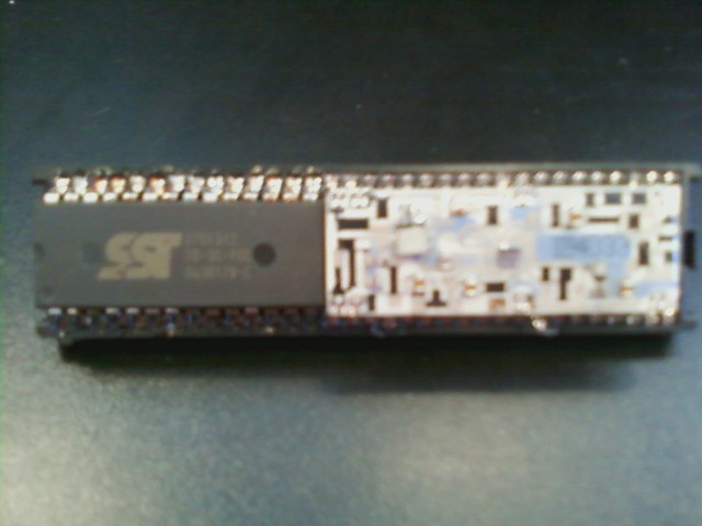

Addicted2bass Posted July 12, 2011 Report Posted July 12, 2011 Sorry for the bad picture, its from my phone. Ill try to upload a better one later. Is this a Kenny Hot Tune chip?? Just has the letters SST on it. I need to know what T-stat to run with this chip. Quote
RobertISaar Posted July 12, 2011 Report Posted July 12, 2011 no idea. for all i know, it could be one of mine, i like those SST SF512s. got an ALDL cable? can do a small ROM dump around the fan on/off settings and see what it's setup for. Quote

White93z34 Posted July 13, 2011 Report Posted July 13, 2011 based on the fact that Jeff M used original eproms, just reflashed with his code it is not a Jeff M. chip. he also wrote what it was on a label on top of the chip it is one of 3 things. a Kenny K. Hot Tune chip a Flybynite (Adam) chip or someones own custom chip / copy of one of the other chips. My money is going on a Kenny Hot tune Quote
Turbo v-sick Posted July 13, 2011 Report Posted July 13, 2011 Not mine I still use Atmel 29C256 style eeprom's. I am fairly certain it's Kenny's hot tune. Most of Kenny's tunes incorporated the 180 stat unless otherwise specified. Find out at what temp the radiator fan comes on and that will let you know which tune you have.... Quote
