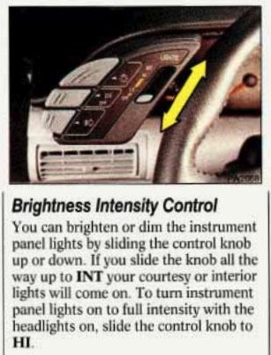

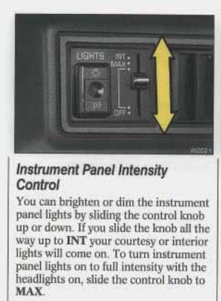

    Move the slider all the way up to MAX, right before INT. It has its own detent. Grand Prix should have the ability too, but it says to move it to HI. Don't have a GP any more so can't verify it's truly 100% as bright as lights-off brightness, but the Cutlass one definitely is. That VFD is scorching bright at night.

    All my Cutlasses had the feature where you could force it to full brightness at night, essentially overriding "night mode" with park/headlamps on. I can't remember if the TGP was lacking that feature or not.

    Are you sure there isn’t another notch on the dimmer? Or is there a chance the dimmer switch could be defective? I can turn everything off when the lights are on, then it goes to full backlight brightness with all of the VFDs dimmed a bit. Then there is detent that brings all of the VFDs to full brightness level. After that, you have the detent that turns on the interior lights. I know for certain my 88,89 and 92 Regal had/have this, as did my 94 Silverado. The 88 and 89 both had the digital dash, and I could run it at full brightness level when the lights were on.

    Doesn't the dimmer switch already allow this? My Regal has a detent immediately before it turns on the interior lights where the cluster and all the displays are at full brightness. I seem to recall my 92 cutlass being the same way, as well as my parents old 97 Lumina....so I just assumed they all worked the same way.

    Don't know if you want to do that...the dimmer is integral in the headlight assembly, if you *at the moment* are seeing the cluster lamps *dim* when you bring on the headlamps then push up the dimmer lever to all the way bright. In that position the cluster lights won't change their brightness. If you haven't altered the wiring for the fogs they only come on when the lows are in use.
