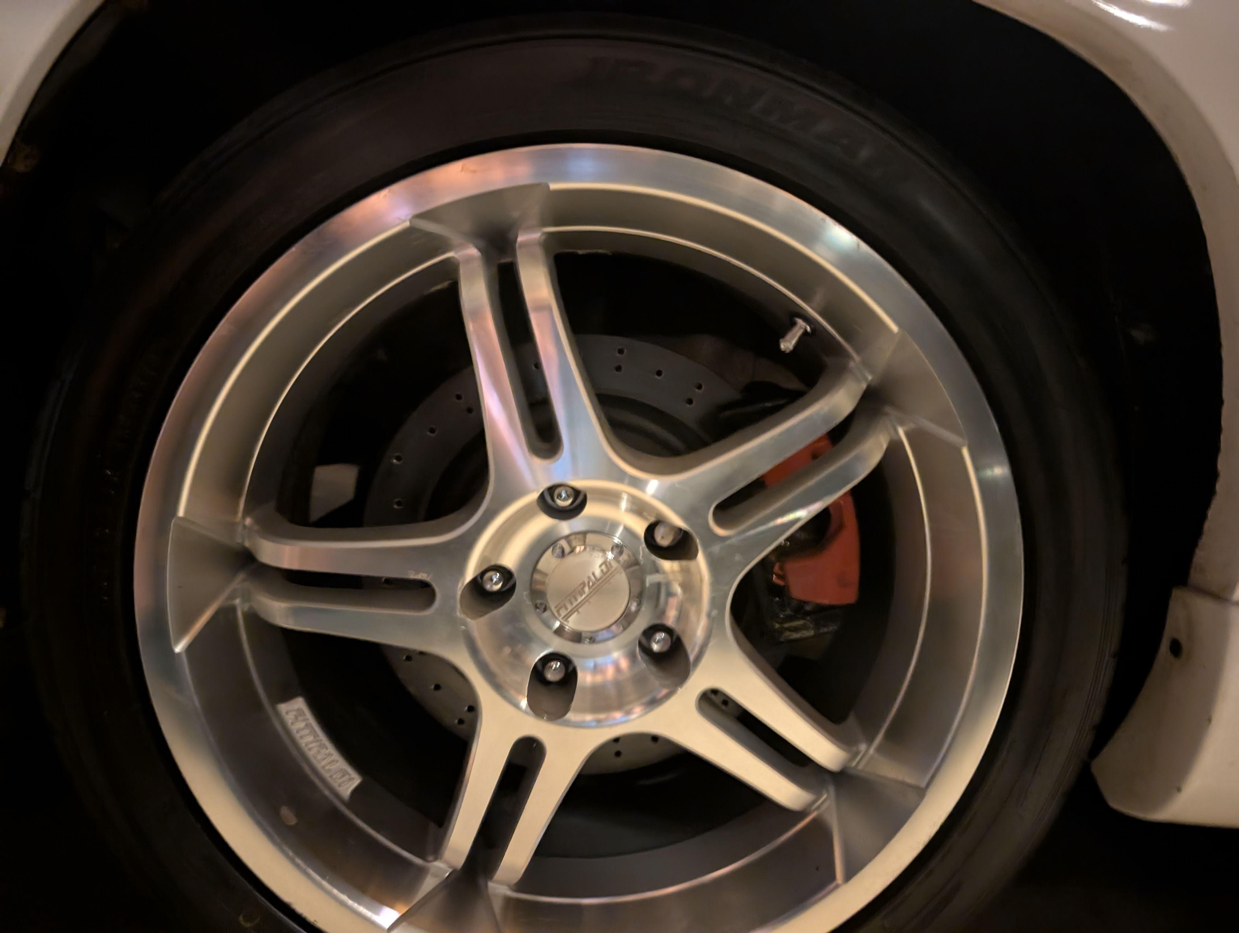

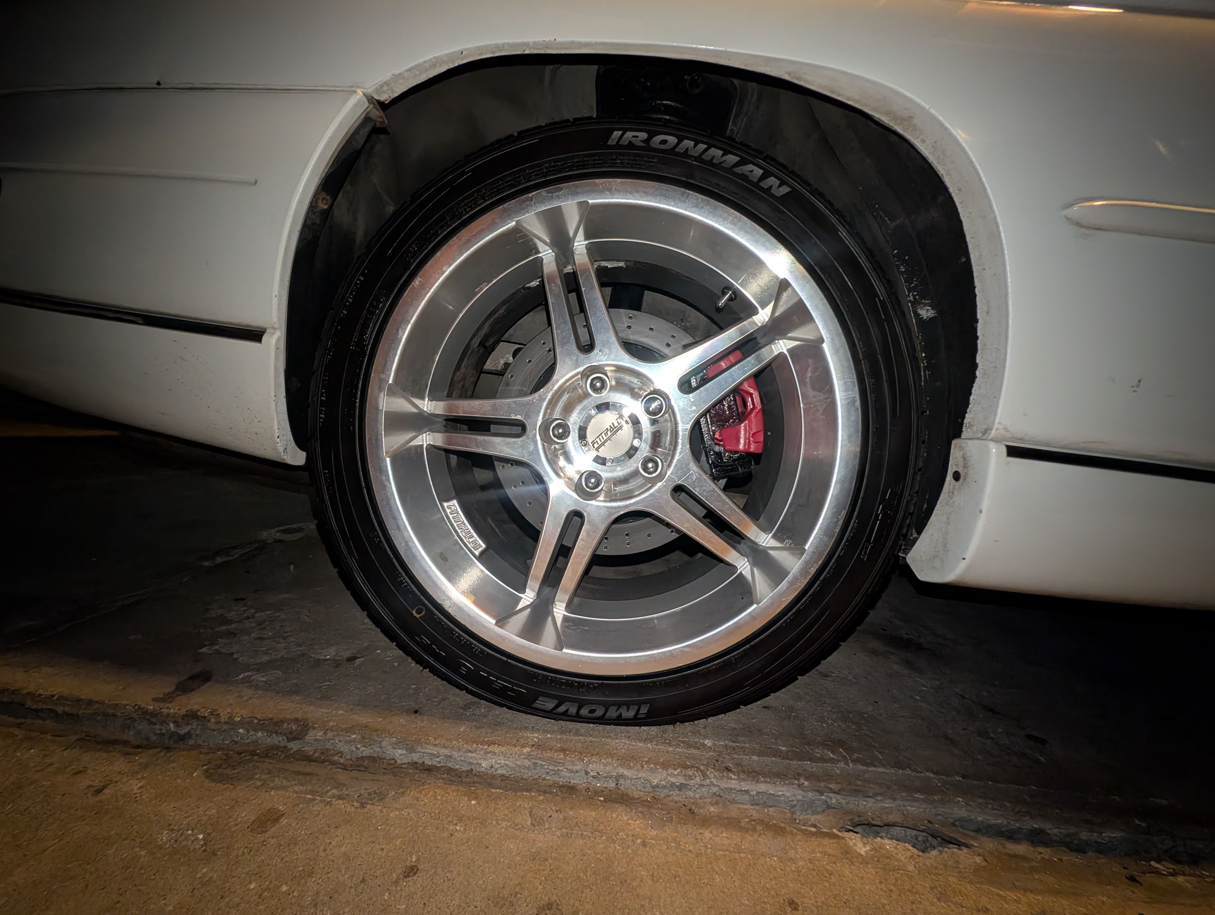

  2. Got the knuckles swapped over and the GXP brakes installed. Going to tackle the e-brake next. Going with a rip-it style handle from an 04-ish J-body and a center console from an 00+ Monte. I have new rear e-brake cables from a 2G, so I'm going to need to figure out how to mate them with the Cavalier one. I know there's a thread somewhere on going to this style e-brake, but I can't find it. Anyone know where it is?
  3. Today
  4. be careful with the springs. they are huge and under more tension then i've seen on most others. Nearly killed myself when one went orbital on me. That said if you're going that far its perhaps worth your while to get some 96' knuckles so you can run the larger rotor
