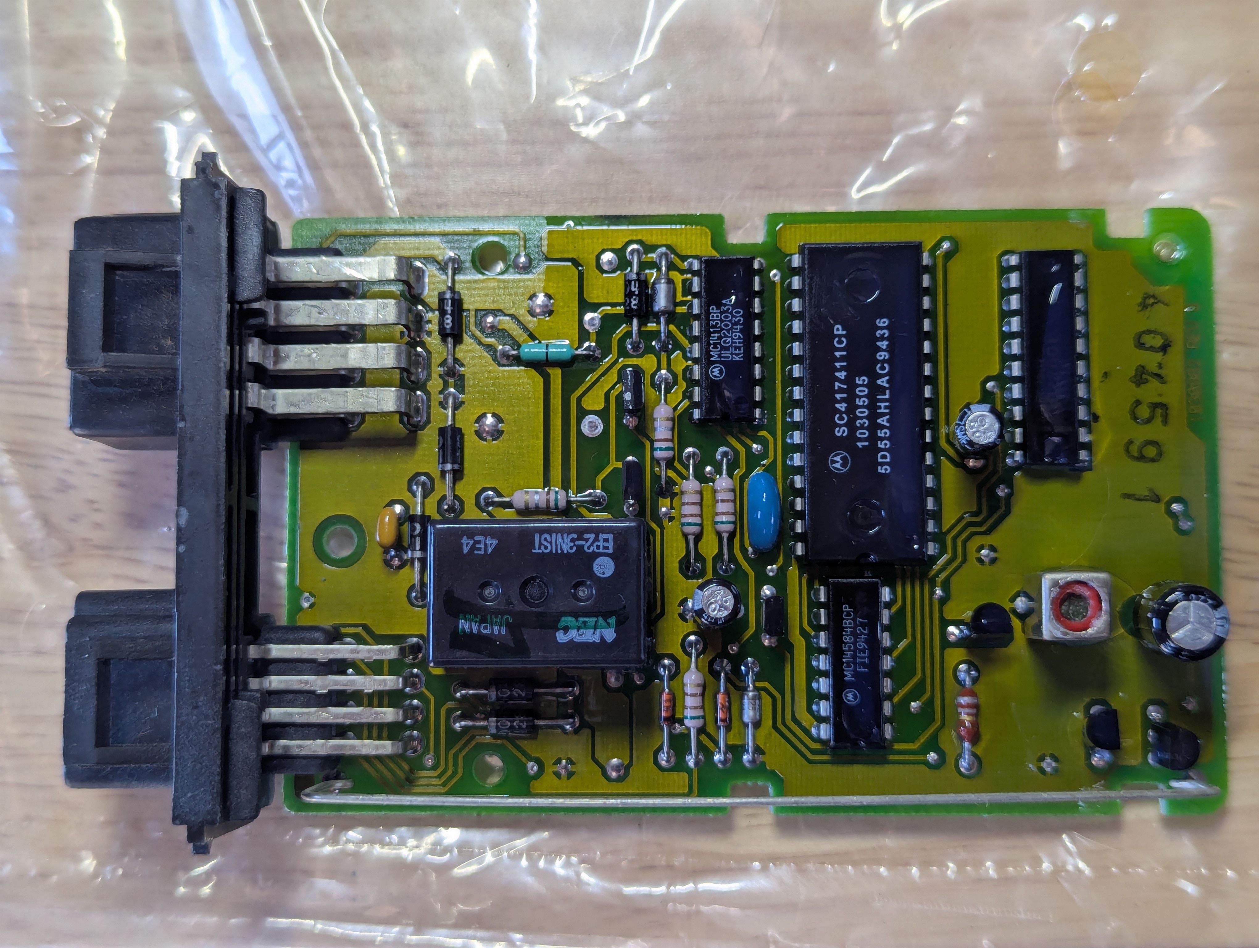

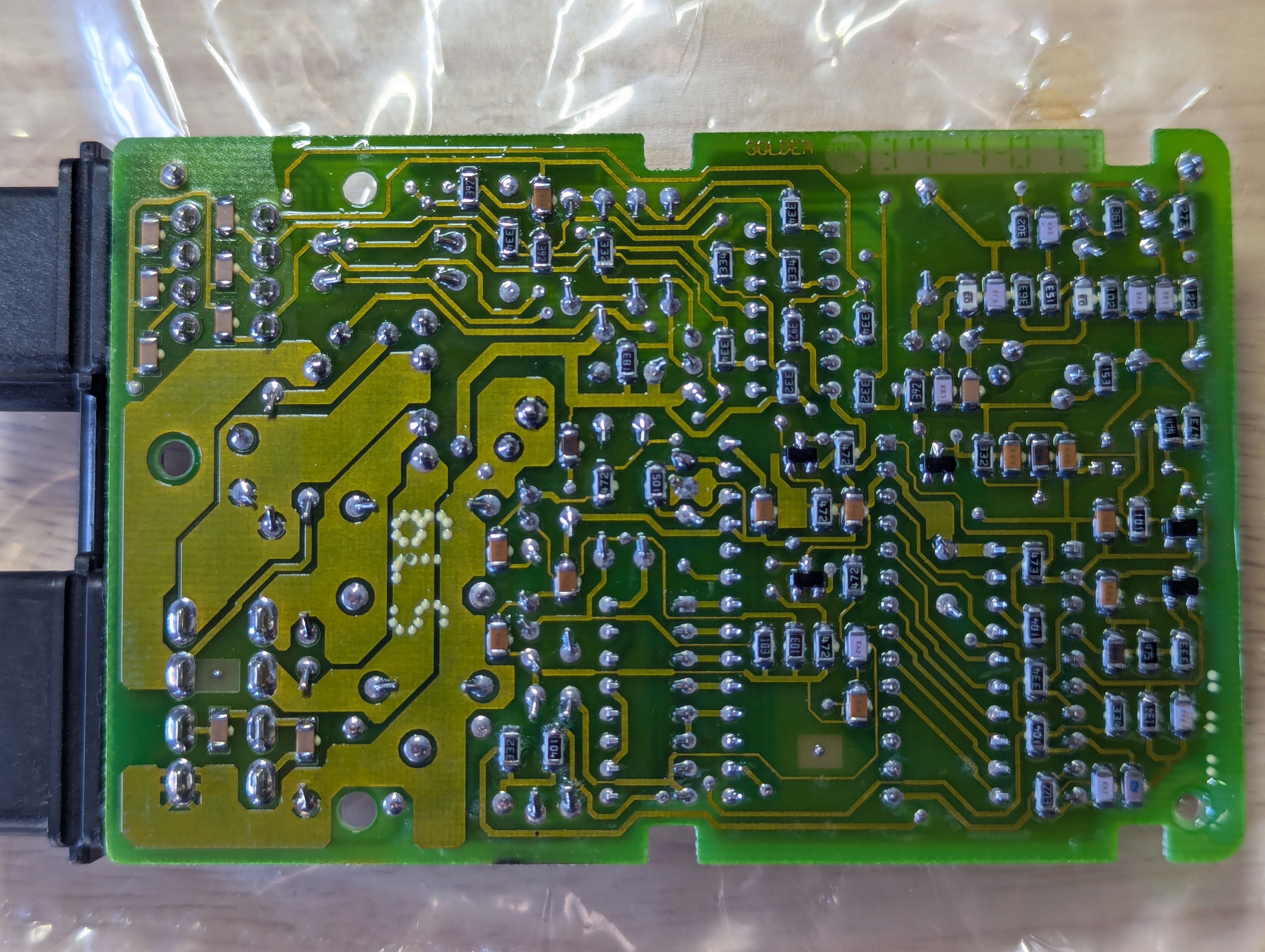

    TRW Keyless Entry module
    The board looks pretty clean...can't see any damage at all and starting to doubt its this issue...?

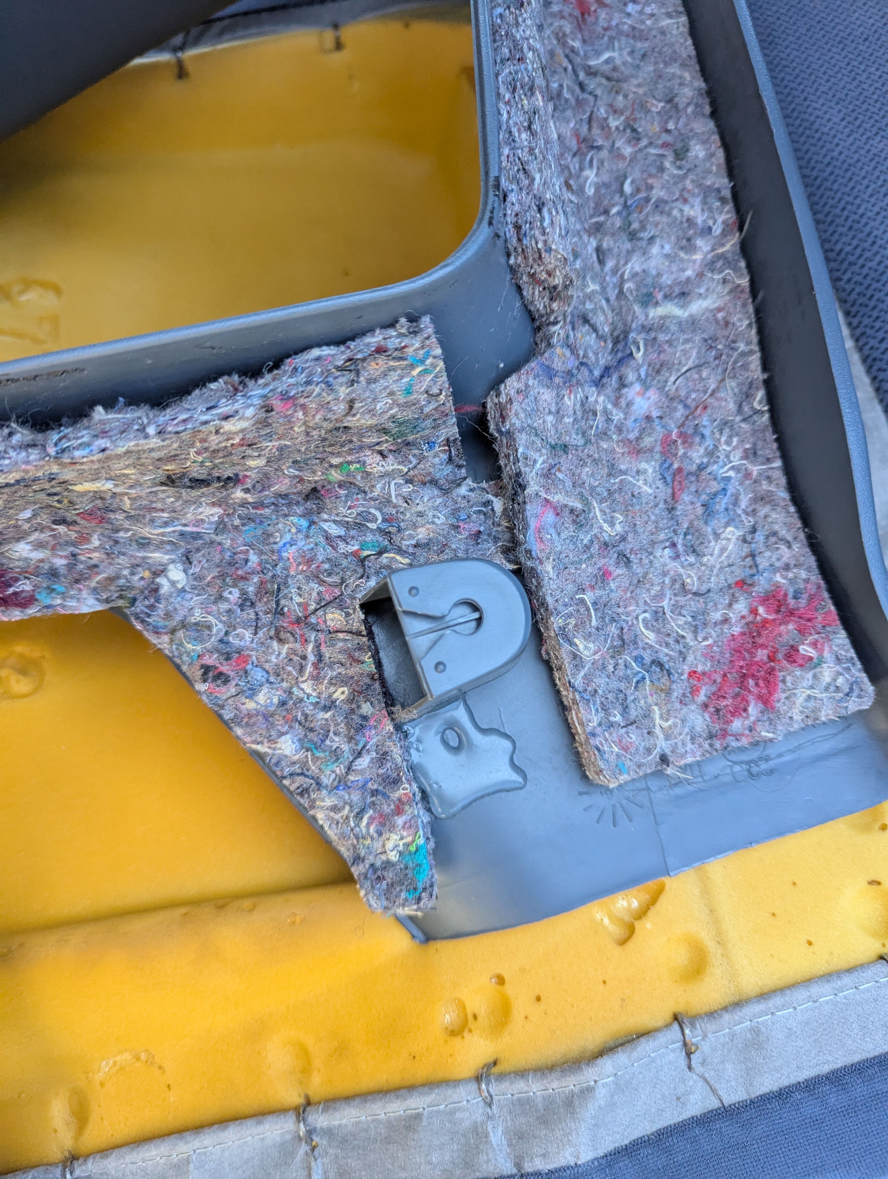

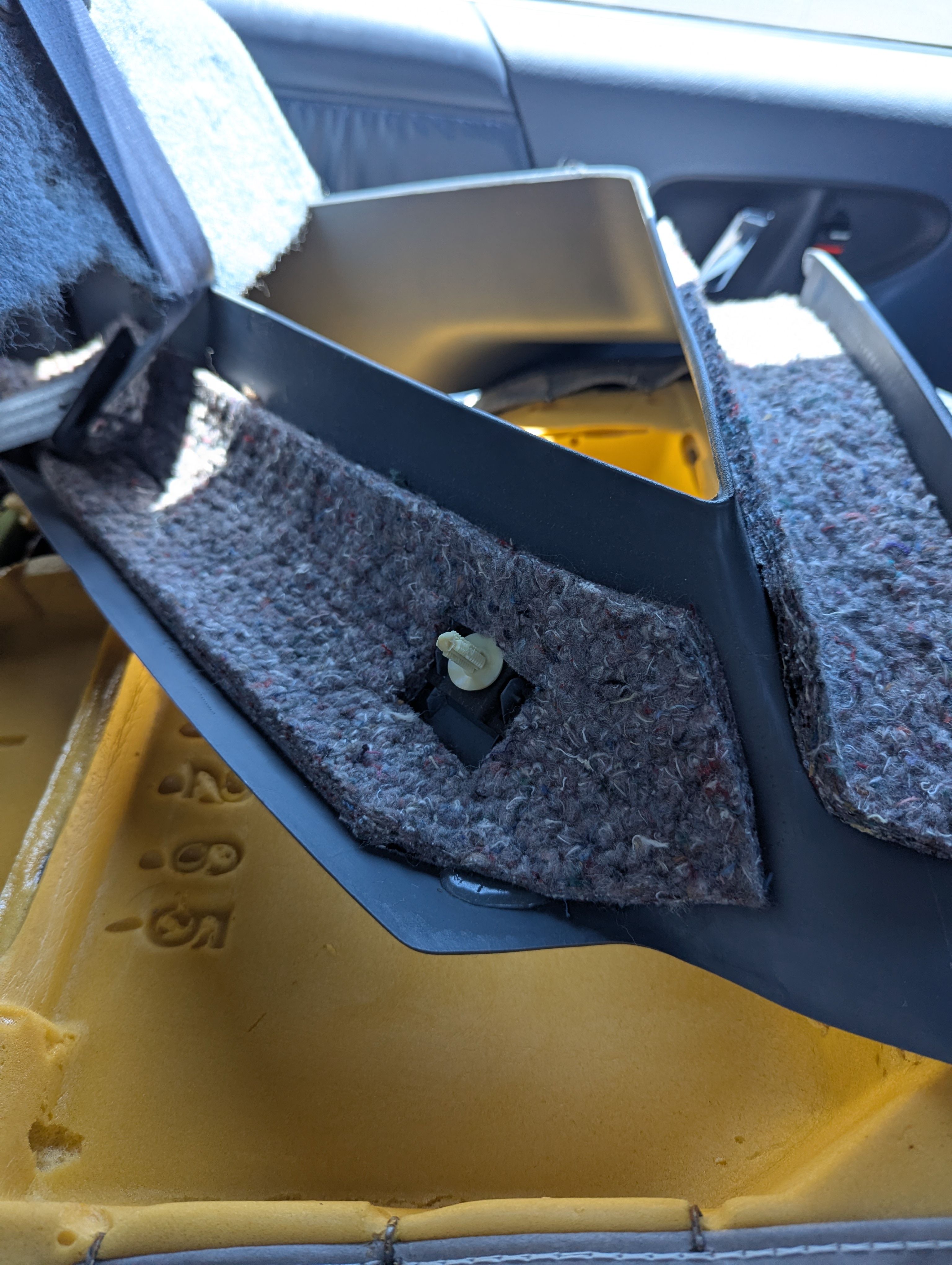

    Thanks that diagram helps. Got my neighbor to help. Putting these photos up for anyone else that finds this thread. Two red clips at the top of door, one white xmas tree clip, and a clip on the inside of the car that requires you pull the panel forward to release.
  4. GnatGoSplat
    Yeah, I hate those one time use clips. I don't have the factory service manual, only parts catalogs, but there appear to be no fasteners for that part other than one staple (#3) towards the bottom. Not sure if that staple has to come out. It looks like the same annoying clip setup my Cutlass Supreme has along the top edge. If I recall the metal clip parts have sharp barbs and dig into the plastic, so some wear to the plastic happens every time you pull it. If the plastic tabs don't break off, they usually go back on and fit well enough, but it's not something you want to have to pull often. Looks like something near the top of the quarter glass and I'd guess that's an xmas tree type clip.
    Thanks for the help. I got them off with a puller but couldn't do it without some damage. Hope they stay snug once I get 'em back in. I'm at the plastic trim around the glass now before I can lift the felt cover out. Any tricks with the trim? I don't see any fasenters so think I just need to pry off?

  7. GnatGoSplat
    Unfortunately, they are indeed Xmas tree type. I used a standard trim panel puller to remove them. I was able to reuse mine after pulling, but it's possible they lost some strength after pulling.
