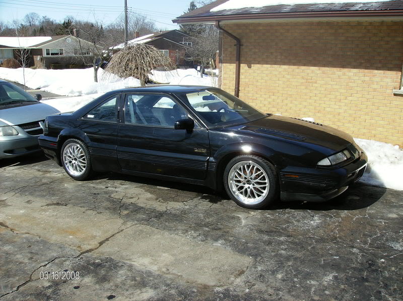

Since this is being brought up soo much, Im going to make this a one shot deal with where you can get all the parts you need and all the options to lower your W-Body!   This will be for 1st gen W-body's, which include:   1988–1996 - Buick Regal   1988–1997 - Oldsmobile Cutlass Supreme   1988–1996 - Pontiac Grand Prix   1990–1994 - Chevrolet Lumina   First we will start with the Front Suspension of your car. Here you have a few choices.     1st - Held Motorsports Coilovers (Arraut
