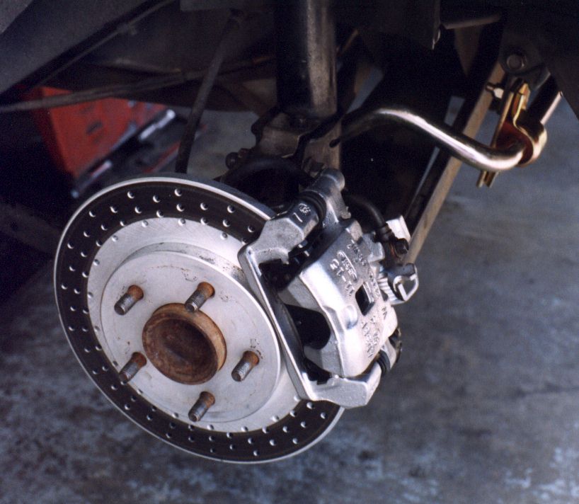

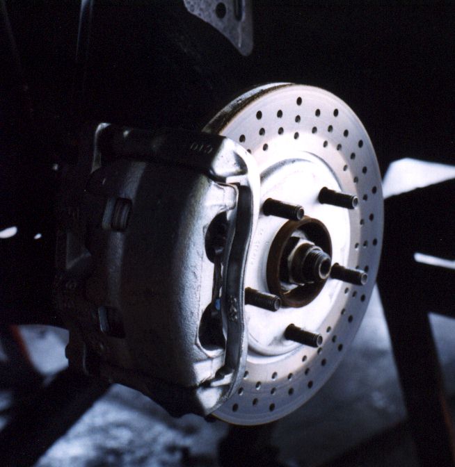

Option 1: Eurorotor has cross-drilled rotors for W-body cars. Here are some pictures of the Eurorotor cross-drilled rotors courtesy of Kevin Heider.
 Front Rotor Rear RotorFront, 88-93 style (10.5"), silver cadmium plated, drilled Eurorotor on a 90 GP. The caliper is painted with Aluminum colored high-heat paint from an auto parts store. The rotor is is listed at http://www.cyberauto.com under Chevy Lumina and Pontiac Grand Prix. It is part #5566-CD, $77.94ea. The plating is an extra $15 each. Rear, 94+ style (11"), silver cadmium plated, drilled Eurorotor on a 90 GP. The caliper is painted with Aluminum colored high-heat paint from an auto parts store. The rotor is is listed at http://www.cyberauto.com under Chevy Lumina and Pontiac Grand Prix. It is part #55110CD at $100.10ea. The plating is an extra $15 each. They are available from:
