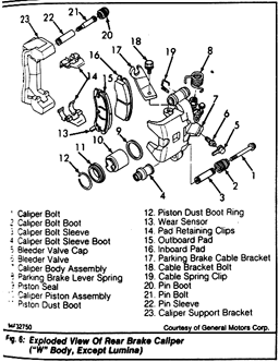

Here's a diagram of the rear disc setup:
