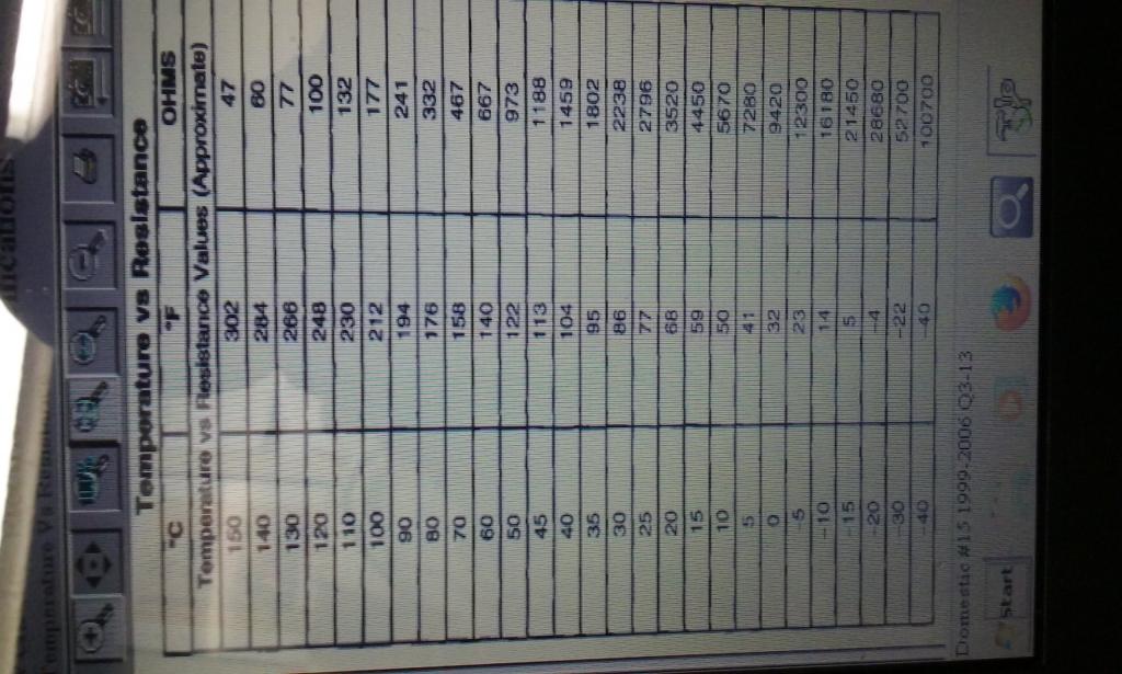

I wonder if you have a bad cts? Colder false reading should generally equate to a richer condition though. It might be a good idea to check it with a DMM against a truth table.
How do you mean? If it was bad, wouldn't it not show the temperature climbing gradually? I've heard all the aftermarket ones are junk like half the other sensors for our vehicles. Would it be beneficial to pick up one at the junkyard? I just really don't want to have to bleed the coolant again...

As far as the temperature measurements, everything matched up correctly for the iat, but since I painted my lim, the readings for the coolant temp sensor was strange where the lim measured lower than the reading and the external reading directly on the sensor was higher than the reading. So not sure if that's normal?
